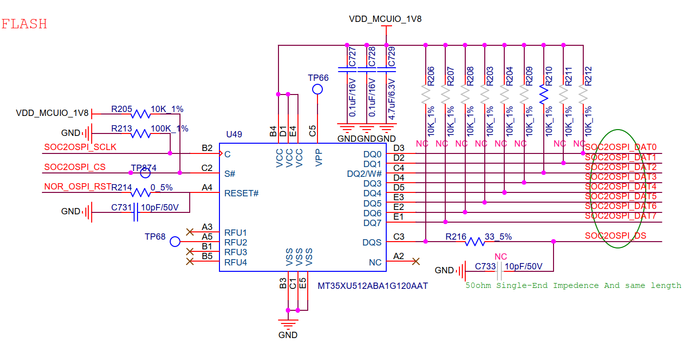

Dear experts
make BOARD=j721e_evm CORE=mcu1_0 sbl_ospi_img_hlos -j64
I compiled uboot.img using the following commandmake ARCH=arm CROSS_COMPILE=aarch64-none-linux-gnu- j721e_evm_a72_defconfig make ARCH=arm CROSS_COMPILE=aarch64-none-linux-gnu-
Dear experts
Hi Karan
I have burned 5 files to nor flash
1.tiboot3 flash to address 0x0
2.tifs.bin flash to address 0x80000
3.app flash to address 0x100000
4.u-boot.img flash to address 0x280000
5.nor_spi_patterns.bin
flash to address 3fe0000
File app is combination of files u-boot-spl.bin and ipc_echo_testb_freertos_mcu1_0_release_strip.xer5f.
