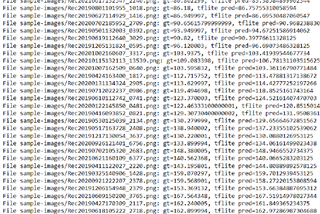

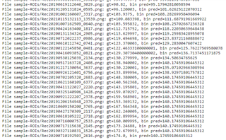

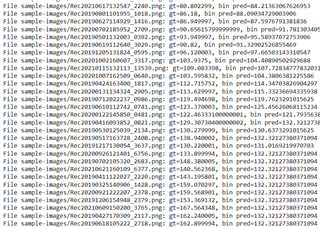

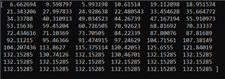

The 16bit binaries can be generated without any issue. When evaluated the performance, we found that the outputs are cut-off at around 132. In other words, it works well on any images with groud truth <132. For input iamges with groud truth>132, it output fixed values like 132.1528. Seems like the value got overflow somewhere. Output predictions look like below.
binary_predictions
We then uploaded the float tflite model and images to TI Edge Cloud to generate model binaries, and found it has exactly the same problem, like below,
We then tested it with TIDL importer under the SDK TDA4VL, same again. Our float tflite model does not have this problem. Below is the output from our float tflite model, everything is good.

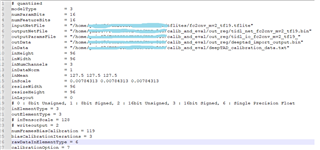

  • Hi Yongquan, thanks a lot for sharing your files. I was able to reproduce your results. However, I don't think it is a saturated output issue to 132.32. In your notebook I increased the advanced_options:calibration_iterations to 50 and output for samples files with higher gt (>140) now shows 140,17.

  • When the advanced_options:calibration_iterations=3, the outputs were capped at around 132.  When the advanced_options:calibration_iterations=50, the outputs were capped at around 140 which is as shown in the above reply. No matter what calibration_iterations was tried, the output were capped at an value.  In addition, for 15 selected samples that have gt<60 (outputs were not large enough to be capped), the MAE(gt, prediction) showed an obvious increase wen changed the calibration_iterations from 3 to 50.
