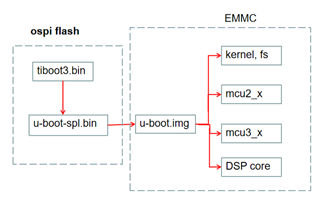

Now i want to start tda4 with ospi + emmc on linux SDK8.4 platform.

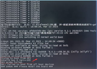

i build u-boot-spl.bin and it save on ospi flash. now i use u-boot-spl.bin to boot uboot, but uboot is save on emmc.
so i want to read uboot image from emmc on u-boot-spl.bin.
in this file(u-boot-2021.01+gitAUTOINC+a169f42610-ga169f42610/arch/arm/mach-k3/j721e_init.c) , i find that spl_boot_device() function read image from BOOT_DEVICE_SPI.
How to modify it to emmc?
i find that there two emmc define, BOOT_DEVICE_MMC and BOOT_DEVICE_MMC . which one is i want?
