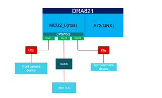

Hi expert,
Now customer run RTOS+QNX(SDK8.0) find  QNX will stuck and it will cause network work abnormal on QNX site. When the issue reproduced, the following phenomena are worthy of attention.
    1. MCU2_0 can send and receive IPC message with QNX
    2. MCU2_0 will print link down & link up message when  plug and unplug the network cable
    3. QNX start a new process will be failed if this process is related with “QNX devctrl
    4. Ifconfig command will be stuck on QNX
    5. We also dump all of the register value when the CPSW5G work normally and abnormally.2311.dump_821_cpsw_reg_error.txt4721.dump_821_cpsw_reg_normal.txt
  • Customer will share the below driver code and reproduced step.

  • MCU2_0 can send and receive IPC message with QNX
    For the above statement, for send & receive IPC message with QNX, can you tell us the what firmware image being loaded? Is it the ipc_echo_test firmware image?
    For this statement, what is running on MCU2_0 core ? Is the EthFW image loaded? Can you share this log which show the link down & link up message?
    What is the new process referred here? Please share the complete "slog2info -w".
    Can you share details on how you are starting the network driver?

  • By the way, all of the test base on MCU2_0 is ETHFW firmware.
  • Can you explain why ipc_test program is run on when the MCU2_0 core is running EthFW firmware? Please note that ipc_test need to be run when the MCU2_0 and other cores are loaded with ipc_echo_test firmware images. So I think you test scenario has a fundamental flaw or if you can explain otherwise. Also, please clarify other questions that is posted above to help understand the issue reported?

  • Hi Praveen,
    The ipc_test is customer modified by theirselve in order to communication with MCU2_0. Meanwhile the MCU2_0 is run ETHFW firmware and there is  a IPC task receive and send IPC message. This is customer project demand.  For other things need further clarify show as below:
    MCU2_0 is loaded ETHFW firmware.
    Yes, all of these test is loaded ETHFW firmware. The log will be share later.

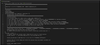

    Could you help explain what's mean start the network driver? In my understand, the MCU2_0 loaded ETHFW and it will configure CPSW5G and then the network driver should be stated when QNX boot normally.

    The attached log is not proper. Suggest sharing the full log from the OS start including the network driver initialization
    Yes, On the A72 side, when QNX boot normally, we are starting the CPSW5G virtual thin client DEVNP driver that interacts with EthFW. This is the network driver that is being referred here. We need details on the parameters passed when starting the driver. and logs that are generated from the start.
    To proceed further, we suggest if you can reproduce this problem on a TI EVM and shared us the steps to reproduce. Or alternatively, we can have a meeting to discuss the customer setup as we are unable to understand their setup clearly.

    I looked at the logs that were shared and have some questions:
    1. The qnx_log.txt and the slog.txt and the r5f_log.txt seem to line up with the ipc_tests that were run. Seems like the test was run 16 times. Was the script aborted after that? It is not clear from the logs. Was the test aborted after you started seeing the rx_queue full errors (starting line 261 in slog.txt)?
    2. From the slog.txt I see that the cpsw5g driver was launched before starting the test. Was that intended? The last comment says that the issue is reproducible without launching the driver.
    I will look more into the code shared. There seems to be a ipc diag service added on the QNX side. Is that used? I dont see that in the slog.txt log
  • 1.Manually exited the script after the problem reoccurred.
    2.The uploaded log starts CPSW normally
    3.IPC_Diag was used for our diagnosis and was not activated during testing

    Can you  get the following infomation the your board?
    slog2info > /tmp/log.txt
    pidin syspage=asinfo
    and their <device>-evm-ti.build file content . Specifically the line that starts with [+keeplinked] startup-dra821-evm
    It could be different for the board that has the issue, but I am looking for the contents of the build file that builds the QNX IFS
    This is the screenshot for J721s2 build file for our evm. They should have a similar to line number 22
    Thank you for sharing the info.
    I reviewed the files that you shared and here is what I could gather.
    Assumptions:
    1.  Only Ethernet firmware is the remotecore that is loaded.
    2. Within the ethw firmware binaries only the Ethernet server use case.
    3. Using SBL boot flow. (u-boot based boot flow uses some DDR for DMSC starting at 0xA0000000. This is already being taken care of in their board file, but I mention it here for clarity)
    4. Based on the build file, the carveout is  96MB of DDR at 0xA0000000 (till 0xA6000000) . NOTE: the TI reference build file has 0x60000000 (1536MB - since our reference has more carveout space).

  • Hi Praveen,
    Customer system block diagram are following
    When the issue reproduce on the car, we have check some the following things:
    1. Qnx can execute other program except related to IPC with MCU2_0 and ifconfig command, especially process is related with “QNX devctrl”.
    2. MCU2_0 can run normally because MCU2_0 can output "link down and link up" log when plug in front camera device.
    3. Other SOC can ping front camera device and surround view device.
    4. We have dumped the Qnx log and some register value are attached.
