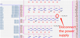

    About VDD_IVA , we tried to remove the power supply of VDD_IVA on J6 board, but the problem remains. no BOOT up.

         5.1 VDD_iva:
          we have a try to disconnect the supply of vdd_iva ,  No effect。
