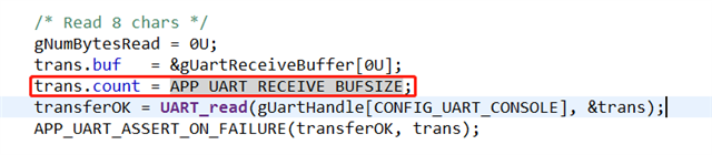

    Could you kindly give some advice,is there anyway to read bytes from uart but not to designate specific numbers?
    For example,if we press up arrow button,now we need to initial trans.count=3.But if we want to input a number 1,we need to intial trans.count =1.How to read a flexible length context from uart?

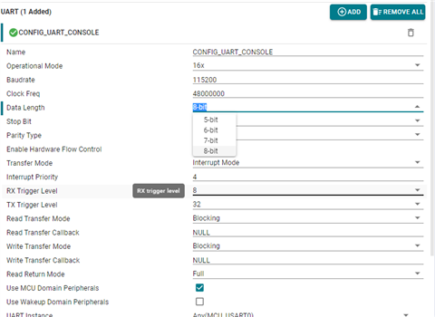

    This could be done with some code changes in functions like UART_read() and UART_write(), but its better to understand/decide the number of bytes you are going to play with. You can change that in sysconfig itself as shown in the image below.

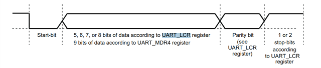

    I think 8 characters meanings for 8 bytes(one bytes has 8-bit length,not 5.6.7) which uart read in function UART_read().
    The data length of 8-bit your points is the data length for each uart transfer.So there will have 8 times 8-bit uart transactions.

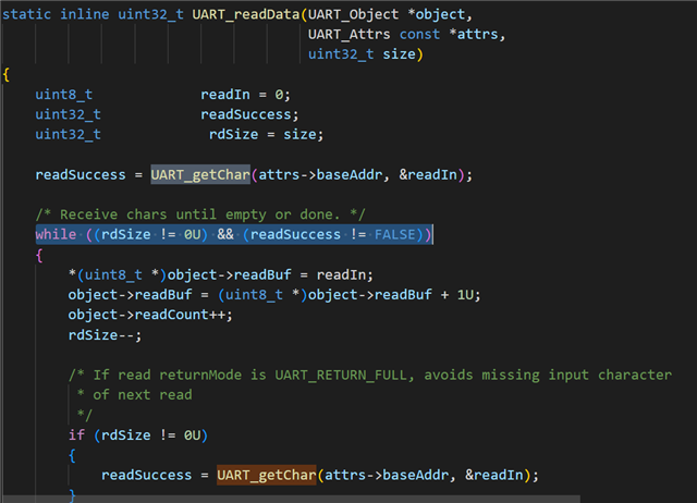

    Now i have an idea to get a flexible length data from uart. Just need to make some changes on function UART_readData called by UART_read().
    Raw code as below, get a specific size then read size of chars from uart.
    Then change to  Check RX_FIFO_E bit in UART_LSR register.If RX fifo has no data then return.
