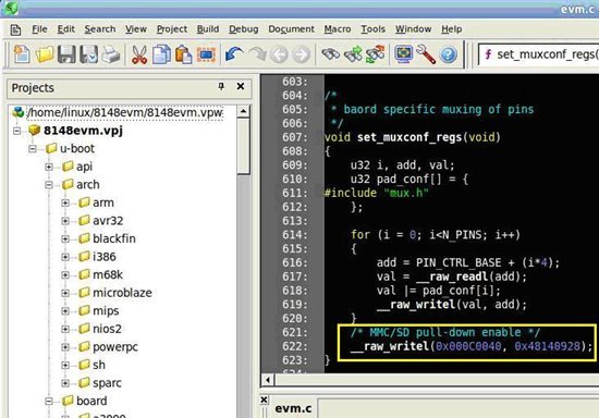

Hi All,
In DM3730 datasheet, we can find the below information. Do anyone know how do set it on DM8148?
I want to use this register to set In/Out and pull up/down for each gpio pin.
For example, in line 622 of the evm.c as shown below (TI814X SDK Ver. 05.00.00.26), we do not know what the 0x000C0040 means here.
Could anyone provide some document about this question?

    My TI FAE was able to provide the bits definition for the PINCNTL registers for the DM814x.   Bit 18 must always be set.
    I provided one example using gp0[18].
    #define PINCNTL_DEFAULT         0x00080000    // This bit must never change from default
    #define PINCNTL_PULL_DOWN       0x00040000    // Pulldown Selected
    #define PINCNTL_PULL_UP         0x00060000    // Pullup Selected
    #define PINCNTL_PULL_DISABLE    0x00050000    // Pullup/Pulldown Disabled
    #define PINCNTL_MUXMODE1        0x00000001    // Select Fcn 1
    #define PINCNTL_MUXMODE2        0x00000002    // Select Fcn 2
    #define PINCNTL_MUXMODE3        0x00000004    // Select Fcn 3
    #define PINCNTL_MUXMODE4        0x00000008    // Select Fcn 4
    #define PINCNTL_MUXMODE5        0x00000010    // Select Fcn 5
    #define PINCNTL_MUXMODE6        0x00000020    // Select Fcn 6
    #define PINCNTL_MUXMODE7        0x00000040    // Select Fcn 7
    #define PINCNTL_MUXMODE8        0x00000080    // Select Fcn 8
    #define pincntl_macro(x,y,z)    (*(U32 *)x = ( *(U32 *)x & PINCNTL_DEFAULT ) | y | z )
    #define pincntl_gp0_18()        pincntl_macro( 0x481408B8, PINCNTL_PULL_DISABLE, PINCNTL_MUXMODE8 ) // PINCNTL47  Debug Pin1
    It is now defined in January Data Manual section Pin Multiplexing Control.
