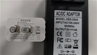

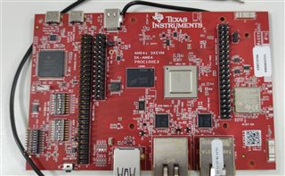

I used 5V3A power supply and also tried 5V4A power supply. After burning the mirror, the serial port has no output, LD15 shows red, LD2, LD16 and LD14 do not light up

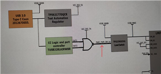

It is newly bought through official channels and used for the first time. After hardware measurement, it is found that the output of PMIC_PWR_SW_En is abnormal
