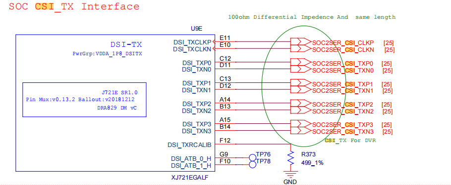

  • The design on our hardware PCB is:
    Based on your SDK, how to achieve the overlay of avm layer and UI layer with minimal changes?

  • 1.Yes, DSP overlaying different display buffs is an implementation, but it may affect the frame rate of the AVM.
    2.The hardware PCB limits us to having to use CSI-TX for the display output.
    3.Your Linux SDK is no longer supported, and we have tried this method for a long time without success.
    4.Currently, DSS can only be controlled in the R5 core to achieve different layer overlays. It is then displayed by CSI-TX encoding output
    5.We want to be able to use DSS overlay manager hardware to do this overlay.
    6.Looking at the DSS overview, the overlay manager can easily do the overlay by setting the alpha value of different layers.
    7.PDK also looks at some pipeline and layermanager configurations.
    8.According to the API in the PDK, how to configure and use can quickly overlay different layers?

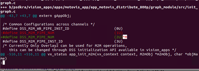

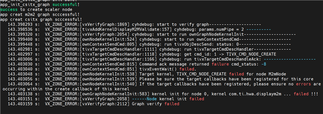

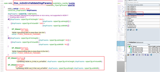

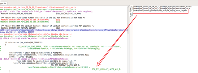

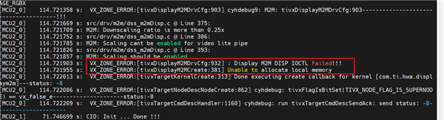

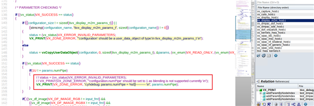

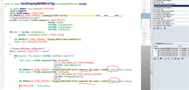

  • Hi, Brijesh:
    I do below modifications:
    and try to set pipe num to 2 before init M2M display node.
    file: dss_m2m.h: dss_m2m.h
    file: dss_soc.h: dss_soc.h
    file: m2m_target.c:

    typedef struct
        /*! IDs=> 0: Write-back pipe-line1 */
        uint32_t instId;
        /*! Number of pipe-lines used, should be set to '1' as blending is not supported currently */
        uint32_t numPipe;
        /*! IDs=> 0:VID1, 1:VIDL1, 2:VID2 and 3:VIDL2 */
        uint32_t pipeId[TIVX_DISPLAY_M2M_MAX_PIPE];
        /*! IDs=> 0:Overlay1, 1:Overlay2, 2:Overlay3 and 3:Overlay4 */
        uint32_t overlayId;

    static vx_status VX_CALLBACK tivxDisplayM2MProcess(
           tivx_target_kernel_instance kernel,
           tivx_obj_desc_t *obj_desc[],
           uint16_t num_params, void *priv_arg);
    static vx_status VX_CALLBACK tivxDisplayM2MCreate(
    static vx_status VX_CALLBACK tivxDisplayM2MDelete(
    static vx_status VX_CALLBACK tivxDisplayM2MControl(
           uint32_t node_cmd_id, tivx_obj_desc_t *obj_desc[],
    static vx_status tivxDisplayM2MSetCreateParams(
                               tivxDisplayM2MParams *prms,
                               const tivx_obj_desc_user_data_object_t *obj_desc,
                               const tivx_obj_desc_image_t *obj_desc_imageIn,
                               const tivx_obj_desc_image_t *obj_desc_imageOut);
    static vx_status tivxDisplayM2MDrvStructsInit(tivxDisplayM2MDrvObj *drvObj);
    static vx_status tivxDisplayM2MDrvCfg(tivxDisplayM2MDrvObj *drvObj);
    static int32_t tivxDisplayM2MCallback(Fvid2_Handle handle, void *appData);

                /* Currently blending is not supported so only one layer is used.
                   This code needs to updated when blending is supported. */
                layerParams->pipeLayerNum[drvObj->createParams.pipeId[0U]] =
                                                    CSL_DSS_OVERLAY_LAYER_NUM_0;
    			layerParams->pipeLayerNum[drvObj->createParams.pipeId[1U]] =
    			            						CSL_DSS_OVERLAY_LAYER_NUM_1;
        vx_status status = (vx_status)VX_SUCCESS;
        uint32_t loopCnt;
        int32_t fvid2_status = FVID2_SOK;
    	VX_PRINT(VX_ZONE_ERROR, "cyhdebug9: M2M: %s:%d--------------------------------------!!!\n", __func__, __LINE__);
        /* Display M2M Driver create */
        drvObj->drvHandle = Fvid2_create(DSS_M2M_DRV_ID,
                                         drvObj->instId,
                                         &drvObj->createParams,
                                         &drvObj->createStatus,
                                         &drvObj->cbParams);
        if((NULL == drvObj->drvHandle) ||
               (drvObj->createStatus.retVal != FVID2_SOK))
            VX_PRINT(VX_ZONE_ERROR, ": Display M2M Create Failed!!!\r\n");
            status = (vx_status)VX_FAILURE;
        /* Display M2M pipe configuration */
        if ((vx_status)VX_SUCCESS == status)
            for (loopCnt = 0U ; loopCnt < drvObj->numPipe ; loopCnt++)
                fvid2_status += Fvid2_control(drvObj->drvHandle,
                                              IOCTL_DSS_M2M_SET_PIPE_PARAMS,
                                              &drvObj->pipeCfg[loopCnt],
                                              NULL);
                                              IOCTL_DSS_M2M_SET_PIPE_MFLAG_PARAMS,
                                              &drvObj->mFlagCfg[loopCnt],
                                              NULL);
                if (FVID2_SOK != fvid2_status)
                    VX_PRINT(VX_ZONE_ERROR, ": Display M2M DISP IOCTL Failed!!!\r\n");
                    break;

    below error was occured:
    log file:
    MobaXterm_COM3ProlificUSB-to-SerialCommPortCOM3_20230328_163601.txt
    Regards.
  • Hi, Brijesh,
    I  mask the judge of pipe num vx_display_m2m_host.c
    the error becomes as follows:
    from the output of app vx_app_arm_remote_log.out:
    it seems that the error occurred while allocating memory:
    log file: MobaXterm_COM3ProlificUSB-to-SerialCommPortCOM3_20230328_173623.txt
    Regards.
  • Hi xie jc,
    The above driver changes look to be fine. But before trying it out in OpenVX node, can we please first check it in the driver example? We need to make sure that driver is working fine before checking it on OpenVX.
    Regarding above error, there are two types of errors,
    1, "Unable to allocate local memory": this error comes when we are trying to allocate more than 10 handles, are you trying to use this node for multiple instances?
    2, also it looks like you are trying to enable scaling on the video lite pipeline, this pipeline does not support scaling. So please make sure to set input and output resolution same, thus disabling scalar.
    Brijesh
  • Hi, Brijesh,
    OK. Which driver sample should we use to check first?
    No. our data flow: uyvy picture -> M2M -> csitx.
    function tivxDisplayM2MDrvCfg() in vx_display_m2m_target.c will call function Fvid2_control(), and Dss_m2mControl() will call by Fvid2_control, and error
    occur in Dss_m2mDrvValidataDispParams()
    Regards.
