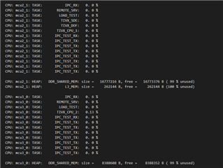

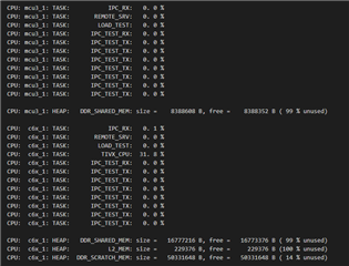

    1. We set the enable_configure_hwa_freq as 0. We think the freq of VPAC is default. Is it 720MHz?
    2. Power reset is power off the whole device, no power supply.

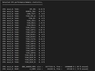

  • ok, can you please press 'p' on the console and share the complete performance stats? It looks like, after 4 hours of run, capture time and viss time is increasing. Any change in running condition? I mean are you running anything in parallel? Are you using SPL boot flow?
    1. The following figures are the complete performance stats during the problem.
    2. I think what you understand is not what I want to express, about the problem. We meet the problem, only 1 time, during an experiment with repeated power-on and power-off, almost 100 times. At the same time, the problem lasted from this power-on to power-off, as the following figures. However, in the remaining 99 tests, frame rate remained normal all time.
    3. We run some apps in parallel, as the following figure.
    4.Yes, we use SPL boot flow.
