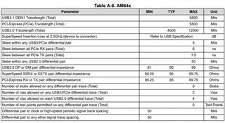

Hi ,
In High-Speed Interface Layout Guidelines (Rev. J) Sheet it's mentioned like for PCIe TX and RX traces we need 95ohm Impedance but by checking the Evaluation Board of AM6412 the Impedance is 100Ohm is being used.
In our case we can follow 100Ohm As per Standards or we need to go with 95 Ohm
Please give Confirmation
