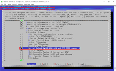

We are using the AM3358 (Linux 4.1.18)
there is one problem, so I have a question.

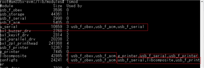

We have good use of the gadget g_printer (USB).
We want to set additional g_serial (USB) additionally.

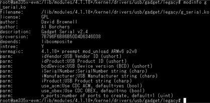

But when I try to insmod g_serial.ko
insmod: ERROR: could not insert module g_serial.ko: No such device
The same error occurs.
I set it like below.
1. kernel config
2. DTS file
3. error
What part do I need to add to make it work normally?
