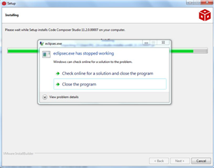

Our customer is not able to install CCS
It's coming like this. After he press close program

Thanks. That should work. I just tried installed CCS 12.2.0 on my Windows 7-64 PC and it went fine. We are unsure what the issue is with the customer.
Few other thoughts:
-Can the customer try temporarily disabling any anti-virus/security software before installing?
-Does the customer have internet access when installing?
ki

He is providing his system info below and asking if you could compare it with yours.
I am also using Windows 7-64 SP1.
Note that the customer PC barely meets the minimum system requirements for CCS 12. In fact, their CPU speed is a bit under. Even if CCS is successfully installed, it will run very slow. I'd recommend trying on a newer PC. Did the customer try on other PCs and if so, were they successful?
Also recommend that they try installing CCS while no other applications are running.
ki
Hi Ki,
The customer updated his system to Windows 10. Now he is able to install CCS in it. He tried your last instructions. Nothing worked for Windows 7.
Anyway, the problem is solved. Thank you again for all the help.
