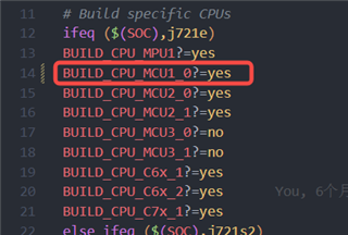

    I reproduce the problem on EVM by SPL boot mode if I enable  MCU1_0 in PSDKRA.
  • Hi Frank,
    Apologies for delay in response.
    What do you mean by enable MCU1_0 is SPL boot mode? Are you telling you are seeing this issue with SPL boot flow as well?
    Parth
  • Hi Parth,
    Yes, I reproduce the issue with SPL boot if I set BUILD_CPU_MCU1_0=yes in psdkra/vision_apps/vision_apps_build_flags.mak before compiling PSDKRA.
    I check the diffrence is the MCU1_0 image in tispl.bin:
    when BUILD_CPU_MCU1_0=no, DM=psdkla/board-support/prebuilt-images/ipc_echo_testb_mcu1_0_release_strip.xer5f  (psdkla/Makefile line 276)
    when BUILD_CPU_MCU1_0=yes,  DM= psdkra/vision_apps/out/J7/R5F/FREERTOS/release/vx_app_rtos_linux_mcu1_0_strip.out
