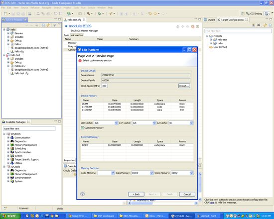

Here is the my platform wizard screenshot,
When i am building my project, i had some errors in the error log, which are something like this.
Description Resource Path Location Type
cannot find file "./configPkg/linker.cmd" hello test C/C++ Problem
errors encountered during linking; "hello test.out" not built hello test C/C++ Problem
Linking failed. Check the Console window for details. hello test Unknown C/C++ Problem
unresolved symbol _ti_sysbios_BIOS_exit__E, first referenced in ./hellotest.obj hello test C/C++ Problem
unresolved symbol _xdc_runtime_System_printf__E, first referenced in ./hellotest.obj hello test C/C++ Problem
creating ".stack" section with default size of 0x400; use the -stack option to change the default size hello test C/C++ Problem
Also attaching the project file
4274.hello test.zip
Here i had attached the all the necessary details of project. If anybody what's going wrong here, then please let me know.

  • Nitin,
    the initial error message that states that configPkg/linker.cmd cannot be found indicates that the configuration step failed. Can you check if there are any error messages further up in the console output?
