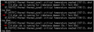

The customer is evaluating thermal behavior using below environment.
HW : SK-AM62 (PROC114E3)
SW : Linux SDK 8.5
Customer confirmed if an internal temp. sensor reaches 105C, the system shuts down to avoid thermal runaway.
(the board was heated externally.)
I thinks this is done by Linux thermal management.

  • Hi Bin,
    The customer tried above, but it seems the device stop working if the internal temp sensor reaches at 105C.
    After that, only temp values are on the log, but other operation, like 3D demo and HDMI output stops.
    The customer wants to keep the device operation even the temp sensor reaches 105C.
