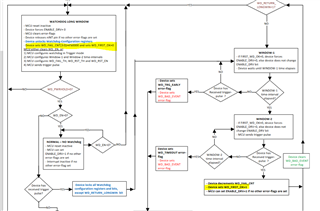

  • Keerthy, Maybe i am not making it clear. We have watchdog implemented in our code. So its not anything default from TI code. We are starting the watchdog as part of our code. Now we have a usecase where we need to stop watchdog from resetting the SoC ( specifically for flashing usecase).
    How do we disable the watchdong after starting the watchdog and its actively monitoring.
    When the watchdog is running a sequence you must first exit the sequence and return to the long window before disabling the watchdog.
    https://www.ti.com/lit/ds/symlink/tps6594-q1.pdf#page=84
    https://www.ti.com/lit/ds/symlink/tps6594-q1.pdf#page=358
    Once the PMIC has returned to the long window then the following bits can be configured: https://www.ti.com/lit/ds/symlink/tps6594-q1.pdf#page=83
    Chris
  • Thanks. How do we know if a sequence is ended/exited.
    What i tried was to send a pulse with twd_pulse after i send the i2c command to return to long window like below
    i2c( return to long window)
    GPIO High
    10ms
    GPIO Low
    i2c ( set wd_en to disable)
    But even in this case, 50% of the time the wdg is not getting disabled. the i2c read says its disabled but the board gets reset after the long window configured time.
    The enable drive pin will go low.  The WD_FAIL_CNT and WD_FIRST_OK will be cleared.
    Is a PWM sourcing the watchdog?  If so, then leave the PWM running until after confirming that the WD_FIRST_OK=0.  Once confirmed then disable the WDOG and then turn off the PWM.

  • Thanks. I tried polling the WD_First_OK and when its 0, i wrote the wd_en to disable. After this i had a while loop counting the number of seconds. the watchdog reset the SOC after 8 seconds ( this is the long window time i have configured)
    GPIO High
    10ms
    GPIO Low
    10ms
    GPIO High
    10ms
    GPIO Low
    i2c ( check if wd_first_ok is cleared)
    while ( wait for x seconds)
    The behavior described is not matching the expected.  Can you confirm that you are using the latest PMIC silicon?  The PMIC configurations should match what is described in the document:
    www.ti.com/.../slvuby7a.pdf
    Device I2C Address Register Address 0x01 Register Address 0x02 Register Address 0x03
    TPS6594141B 0x48 0x82 0x1B 0x01
    LP876441B 0x4C 0x86 0xB1 0x01
    Given the long window expiration matches what you have programmed, the PMIC is entering the Long window correctly but the WD_EN is not being cleared.
    1. Can you confirm what is actually being sent on the I2C bus?
      1. The PMIC is configured to use a dedicated I2C bus on GPIO1 and GPIO2.  Because you are using the trigger watchdog instead of the Q&A watchdog us GPIO2 configured as TRIG_WDOG?
      2. Please confirm the order of operation between configuring the watchdog and changing the GPIO2/GPIO1 interface.
    2. Can you confirm that you are writing to address 0x12, register address 0x09 and bit6 to clear WD_EN?
    3. Please confirm status of the I2C CRC, an incorrect CRC will cause an I2C write to be ignored.
    Chris

    Thank you for the NVM information.  I was referencing the incorrect PDN.  The correct PDN is found here.
    I have recreated the test but I added a step where after configuring GPIO2_CONF to 0x2A I noticed that the WD_PWRHOLD was getting set.  Prior to enabling the test I cleared the WD_PWRHOLD bit.
    I do not set the return to longwindow bit until after the sequence starts.
    /cfs-file/__key/communityserver-discussions-components-files/791/test_5F00_trigWdog.xlsx
    (1) Set NSLEEP Bits to 0x03
    (2) Clear interrupts (ENABLE_INT, BIST_PASS)
    (3) GPIO2_CONF = 0x2A
    (4) Disable watchdog, clear WD_PWRHLD
    (5) Configure win1, win2, etc
    (6) Enable watchdog
    (7) Start PWM
    (8) Confirm WD_FIRST_OK=1 (in sequence)
    (8) Set WD_RETURN_LONGWIN
    (9) Confirm WD_FIRST_OK=0 (in long window)
    (10) Stop PWM
    (11) Disable watchdog
    Can you recreate this on your setup?
    Chris
