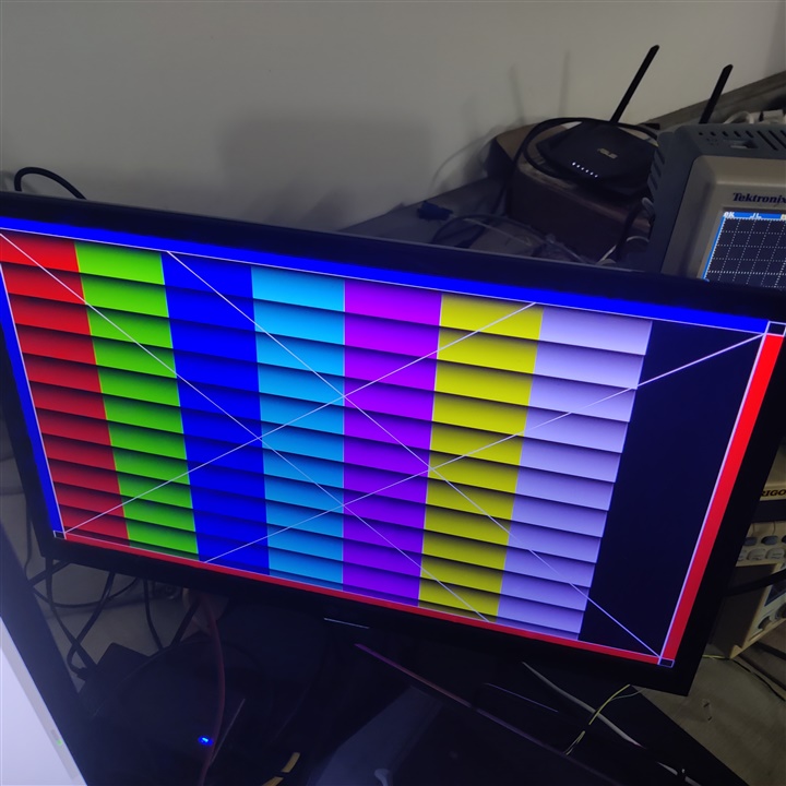

Hello Champs,
Customer made his own board by using DS90CF384AMTDX to convert LVDS to RGB888, using ADV7123 to output VGA to LCD screen.
He used TI filesystem to output  lvds 4-lane RGB888, but the color is wrong. Is the output of TI filesystem rgb565? How to convert it to rgb888?
1. Below is TI demo
2. Below is kmstest
Below is customer's dts configuration

modify the panel-simple.c
static const struct display_timing goworld_ili6150h6_timing = {
 .pixelclock = { 65000000, 65000000, 65000000 },
 .hactive = { 1024, 1024, 1024 },
 .hfront_porch = { 24, 24, 24 },
 .hback_porch = { 160, 160, 160 },
 .hsync_len = { 136, 136, 136 },
 .vactive = { 768, 768, 768 },
 .vfront_porch = { 3, 3, 3 },
 .vback_porch = { 29, 29, 29 },
 .vsync_len = { 6, 6, 6 },
static const struct panel_desc goworld_ili6150h6 = {
 .timings = &goworld_ili6150h6_timing,
 .num_timings = 1,
 .bpc = 8,
 .size = {
 .width = 165,
 .height = 105,
 .delay = {
 .enable = 25,
 .disable = 25,
 .bus_flags = DRM_BUS_FLAG_DE_HIGH,
 .bus_format = MEDIA_BUS_FMT_RGB888_1X7X4_SPWG,
 .connector_type = DRM_MODE_CONNECTOR_LVDS,
