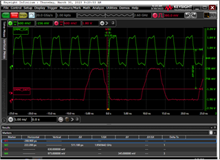

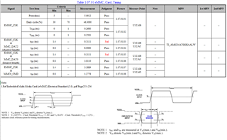

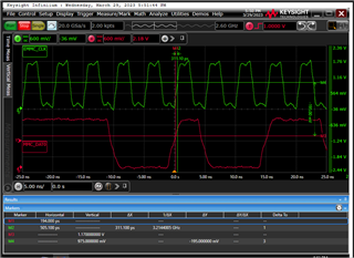

AM6234 EMMC clk to data Tisu waveform fail
1. 如下图,Tisu fail
2. MMC part number "FEMDRM016G-58A43"
  • I assume the waveform captures provided were from a write cycle since you are measuring setup time and comparing it to the eMMC device requirements. If so, it looks like the host controller may not be configured properly. The data is changing on the falling edge of clock rather than the rising edge of clock, so you are losing half of the clock cycle time for data setup. We should also try to understand why the rise/fall time of the data signal is almost double the rise/fall time of the clock signal.

  • I have already said data is being launched on the wrong edge of clock. This is a controller config issue that needs to be fixed.
  • Dear Paul and Bin
    Thank you very much for your support, can you elaborate on how the controller configuration should be modified? What should customers do? Because the signal on our SK-AM62 is not good either.
    BR
    Ethan
  • Hi Ethan,
    I am working internally for the software configuration.
    When you say the signal on SK-AM62 is not good either, do you mean it has the same data/clk shift as that on the custom board?
  • Hi Bin
    Here's the setup time test result on SK-AM62
  • Where were you probing the data signal?  Was it near the AM62x device or near the eMMC device?
    Paul
  • near the eMMC device.

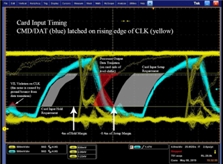

  • If that is the case, the latest scope capture is displaying the timing relationship of the eMMC output rather than the MMCSD host output. I can tell by the shape of the data signal. The data signal will only have the non-monotonic step function at mid-supply on the source end of the signal trace. If you are probing near the eMMC device, you are clearly capturing read data in this scope capture. The data signal would not have this step function near the eMMC device if it were coming from the MMCSD host.
    Your previous concern was related to the timing relationship of the MMCSD host, and I ask if you confirmed the first scope capture represented write data rather than read data. You said that was the case, but now I'm concern you captured the wrong direction on the previous scope capture since you are providing the read data relationship in this capture.
    You must be sure which data direction is being captured to properly understand the timing relationship of read vs write.
    I suggest you probe the data signal near the MMCSD host controller or the eMMC device and place the scope in persistence mode, where it captures both data directions in the same capture. This will allow you to see both data transitions and the one with the step function is the one being sourced by the device near your probe.
  • I probe the data near the eMMC device, and the waveform is write mode, so the data direction is correct.
    the same issue at the persistence mode waveform. (read and write data)
    you can measure the waveform of your demo board (AM62X SKEM PROC114E3).
  • I need you to capture both data read and write timing using persistence similar to what was done in the image inserted below. The attached image was taken from another processor communicating with an SD Card through level-shifters. So the rise/fall times and timing of the signals are not representative of the AM62x device. This is only being provided to show you an example of how I want you to capture the timing relationship of read and write data in a persistence capture. Note: the waveforms colors were labeled wrong in the image. The CMD/DAT signal is yellow and the CLK signal is blue. In this image you can see two transition regions on data waveform. One region has a lot of transitions, and the other region has only a few transitions. The one with more transitions represents read data and the one with less transitions represents write data. I was probing near the SD Card so you can see the non-monotonic steps that occur on the source end of the signal trace of read data. This image shows the write data changing on the falling edge of clock and the read data is delayed from the rising edge of clock. In this case, the high speed enable bit in the host controller was not set which tells the host to launch write data on the falling edge of clock. Write data will be launched on the rising edge of clock when the high speed enable bit is set. Bin has confirmed the Linux driver is setting the high speed enable bit when operating is HS200 mode. So you should be seeing write data changing near the rising edge of clock rather than the falling edge of clock. This is why I think you are capturing read data rather than write data. The only way I can be sure is to see both on a persistence capture.
    Paul
