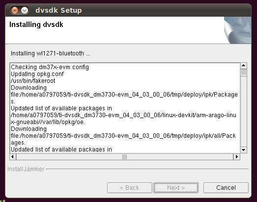

    5. Performed multiple rounds of 'sudo apt-get update' and 'sudo apt-get upgrade' including a reboot to get to the latest-latest Ubuntu 10.04 components
    6. [Optional step, makes working with VMWare Workstation easier to allow file sharing, copy & paste, and better virtual display integration] Installed the VMware guest tools using 'sudo apt-get install open-vm-toolbox'
    7. Started the SDK installer 'dvsdk_dm3730-evm_04_03_00_06_setuplinux' which gave an error about bash/dash re-configuration. Followed the outlined steps needed to resolve this using 'sudo dpkg-reconfigure dash'.
      Note: I did NOT get an error about missing 'fakeroot' you reported as this happened to get installed already as part of my previous step 6 due to it being a dependency of the package I installed. If you still do get the message from the installer tool like shown in your original post you'll need to manually install fakeroot now using 'sudo apt-get install fakeroot'. This should work without any issues at this point with up-to-date Ubuntu apt settings/sources.
    8. Started the SDK installer 'dvsdk_dm3730-evm_04_03_00_06_setuplinux' once more. This time it came up without issues. Then I selected the options to only do a basic BSP/PSP installation, since this is what you were looking for. A couple of screenshots...
    9. Executed the SDK installer's setup script to prepare the SDK for use:
      a0797059@ubuntu:~/ti-dvsdk_dm3730-evm_04_03_00_06$ ll
      total 96
      drwxr-xr-x 11 a0797059 a0797059  4096 2023-05-01 08:38 ./
      drwxr-xr-x 25 a0797059 a0797059  4096 2023-05-01 08:38 ../
      drwxr-xr-x  2 a0797059 a0797059  4096 2023-05-01 08:31 bin/
      drwxr-xr-x  3 a0797059 a0797059  4096 2023-05-01 08:31 docs/
      drwxr-xr-x  2 a0797059 a0797059  4096 2023-05-01 08:31 etc/
      drwxr-xr-x  4 a0797059 a0797059  4096 2023-05-01 08:31 example-applications/
      drwxr-xr-x  2 a0797059 a0797059  4096 2023-05-01 08:31 filesystem/
      drwxr-xr-x  3 a0797059 a0797059  4096 2023-05-01 08:31 host-tools/
      drwxr-xr-x 11 a0797059 a0797059  4096 2023-05-01 08:30 linux-devkit/
      -rwxr-xr-x  1 a0797059 a0797059 42131 2011-12-22 11:00 Makefile*
      drwxr-xr-x  8 a0797059 a0797059  4096 2023-05-01 08:31 psp/
      -rwxr-xr-x  1 a0797059 a0797059  2908 2023-05-01 08:31 Rules.make*
      -rwxr-xr-x  1 a0797059 a0797059   833 2011-12-22 09:19 setup.sh*
      drwxr-xr-x  3 a0797059 a0797059  4096 2023-05-01 08:30 usr/
      a0797059@ubuntu:~/ti-dvsdk_dm3730-evm_04_03_00_06$ ./setup.sh

      Selecting previously deselected package librpcsecgss3.
      Unpacking librpcsecgss3 (from .../librpcsecgss3_0.19-2_i386.deb) ...
      Selecting previously deselected package lrzsz.
      Unpacking lrzsz (from .../lrzsz_0.12.21-5_i386.deb) ...
      Selecting previously deselected package minicom.
      Unpacking minicom (from .../minicom_2.4-1_i386.deb) ...
      Selecting previously deselected package portmap.
      Unpacking portmap (from .../portmap_6.0.0-1ubuntu2.2_i386.deb) ...
      Selecting previously deselected package nfs-common.
      Unpacking nfs-common (from .../nfs-common_1%3a1.2.0-4ubuntu4.2_i386.deb) ...
      Selecting previously deselected package nfs-kernel-server.
      Unpacking nfs-kernel-server (from .../nfs-kernel-server_1%3a1.2.0-4ubuntu4.2_i386.deb) ...
      Selecting previously deselected package xinetd.
      Unpacking xinetd (from .../xinetd_1%3a2.3.14-7ubuntu3_i386.deb) ...
      Selecting previously deselected package tftpd.
      Unpacking tftpd (from .../tftpd_0.17-17ubuntu1_i386.deb) ...
      Selecting previously deselected package uboot-mkimage.
      Unpacking uboot-mkimage (from .../uboot-mkimage_0.4build1_i386.deb) ...
      Processing triggers for install-info ...
      Processing triggers for man-db ...
      Processing triggers for doc-base ...
      Processing 1 added doc-base file(s)...
      Registering documents with scrollkeeper...
      Processing triggers for ureadahead ...
      ureadahead will be reprofiled on next reboot
      Setting up m4 (1.4.13-3) ...
      Setting up autoconf (2.65-3ubuntu1) ...
      Setting up autotools-dev (20090611.1) ...
      Setting up automake (1:1.11.1-1) ...
      update-alternatives: using /usr/bin/automake-1.11 to provide /usr/bin/automake (automake) in auto mode.
      Setting up libgssglue1 (0.1-4ubuntu0.1) ...
      Setting up libncurses5-dev (5.7+20090803-2ubuntu3) ...
      Setting up libnfsidmap2 (0.23-2) ...
      Setting up librpcsecgss3 (0.19-2) ...
      Setting up lrzsz (0.12.21-5) ...
      Setting up minicom (2.4-1) ...
      Setting up portmap (6.0.0-1ubuntu2.2) ...
      portmap start/running, process 24378
      Setting up nfs-common (1:1.2.0-4ubuntu4.2) ...
      Creating config file /etc/idmapd.conf with new version
      Creating config file /etc/default/nfs-common with new version
      Adding system user `statd' (UID 115) ...
      Adding new user `statd' (UID 115) with group `nogroup' ...
      Not creating home directory `/var/lib/nfs'.
      statd start/running, process 24602
      gssd stop/pre-start, process 24625
      idmapd stop/pre-start, process 24651
      Setting up nfs-kernel-server (1:1.2.0-4ubuntu4.2) ...
      Creating config file /etc/exports with new version
      Creating config file /etc/default/nfs-kernel-server with new version
       * Exporting directories for NFS kernel daemon...                                                                                                                                                                                    [ OK ]
       * Starting NFS kernel daemon                                                                                                                                                                                                        [ OK ]
      Setting up xinetd (1:2.3.14-7ubuntu3) ...
       * Stopping internet superserver xinetd                                                                                                                                                                                              [ OK ]
       * Starting internet superserver xinetd                                                                                                                                                                                              [ OK ]
      Setting up tftpd (0.17-17ubuntu1) ...
      Note: xinetd currently is not fully supported by update-inetd.
            Please consult /usr/share/doc/xinetd/README.Debian and itox(8).
      Setting up uboot-mkimage (0.4build1) ...
      Processing triggers for libc-bin ...
      ldconfig deferred processing now taking place
      Package verification and installation successfully completed
      In which directory do you want to install the target filesystem?(if this directory does not exist it will be created)
      [ /home/a0797059/targetfs ]
      This step will extract the target filesystem to /home/a0797059/targetfs
      Note! This command requires you to have administrator priviliges (sudo access)
      on your host.
      Press return to continue
      Successfully extracted dvsdk-dm37x-evm-rootfs.tar.gz to /home/a0797059/targetfs
      This step will update the EXEC_DIR variables in the Rules.make file
      This will facilitate the SDK to install (with make install) rebuilt binaries in
      The files will be available from / on the target.
      This setting can be changed later by editing Rules.make and changing the
      EXEC_DIR variable.
      Rules.make edited successfully..
      This step will export your target filesystem for NFS access.
      on your host.
       * Stopping NFS kernel daemon                                                                                                                                                                                                        [ OK ]
       * Unexporting directories for NFS kernel daemon...                                                                                                                                                                                  [ OK ]
      Which directory do you want to be your tftp root directory?(if this directory does not exist it will be created for you)
      [ /tftpboot ] --------------------------------------------------------------------------------
      This step will set up the tftp server in the /tftpboot directory.
      on your host.
      Successfully copied uImage-dm37x-evm.bin to tftp root directory /tftpboot
      [sudo] password for a0797059:
      /etc/xinetd.d/tftp successfully created
      Restarting tftp server
      This step will set up minicom (serial communication application) for
      DVSDK development
      Which serial port do you want to use with minicom?
      [ /dev/ttyS0 ]
      Configuration saved to /home/a0797059/.minirc.dfl. You can change it further from inside
      minicom, see the Software Development Guide for more information.
      This step will set up the u-boot variables for booting the EVM.
      Autodetected the following ip address of your host, correct it if necessary
      [ 192.168.88.129 ]
      Select Primary display output:
       1: LCD
       2: DVI
      [ 1 ]
      Select Linux kernel location:
       1: TFTP
       2: SD card
      [ 1 ] 2
      Select root file system location:
       1: NFS
       2: SD card
      [ 1 ] 2
      Resulting u-boot variable settings:
      setenv bootdelay 4
      setenv baudrate 115200
      setenv bootargs console=ttyO0,115200n8 rw mem=55M@0x80000000 mpurate=1000 mem=128M@0x88000000 omap_vout.vid1_static_vrfb_alloc=y omapfb.vram=0:4M root=/dev/mmcblk0p2 rootfstype=ext3 rootwait ip=off
      setenv bootcmd 'mmc init;fatload mmc 0 0x82000000 uImage;bootm 0x82000000'
      Would you like to create a minicom script with the above parameters (y/n)?
      [ y ] n
      TISDK setup completed!
      Please continue reading the Software Developer's Guide for more information on
      how to develop software on the EVM
    After these steps I was able to build X-Loader with the provided Makefile....

    Can you double check your steps to see what might be missing?
    I suspect you might be missing step 3 (setting up proxy server), and perhaps step 5 (updating Ubuntu).
    Regards, Andreas
