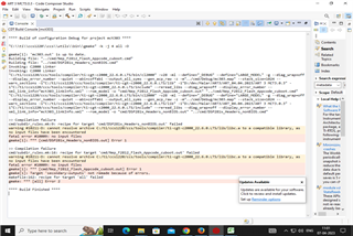

I got these errors while compiling in CCS.
#10009 no input files
gmake: *** [all] Error 2
gmake[1]: *** [cmd/DSP281x_Headers_nonBIOS.out] Error 1
gmake[1]: *** [cmd/Nep_F2812_Flash_Appcode_cuboot.out] Error 1
gmake[1]: Target 'secondary-outputs' not remade because of errors.

                    It appears you are using TMS320F2812. This is a fairly old device (the very first C2000 MCU with the c28x core) that does not have C2000ware Driverlib support, which is offered for more recent C2000 devices. Have you installed the C281x C/C++ Header Files and Peripheral Examples from https://www.ti.com/tool/SPRC097? If so, please try out a supplied example and let us know if it compiles OK. You may also want to install the latest CCS version 12.2.

             I presume you have already installed the DSP28x header files (SPRC097  C281x C/C++ Header Files and Peripheral Examples). If you have, you should see a directory structure similar to the below:
    I think I need the following file to solve my issue.
    1. cmd/DSP281x_Headers_nonBIOS.out
    The DSP281x_Headers_nonBIOS.cmd file should be present in C:\tidcs\c28\dsp281x\v120\DSP281x_headers\cmd
    2. cmd/Nep_F2812_Flash_Appcode_cuboot.out
    This is your application code. It is not part of the header files.
