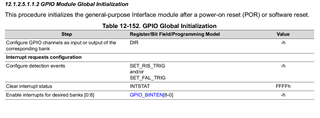

    I could finally follow your example for Linux. It worked great which is good news for me.
    Now the next step is to replicate it with my own driver.
    Following is mainly FYI: The value 486 can be determined by running gpioinfo gpiochip2 and searching for USER_LED1 (which corresponds to line 22). Running gpiodetect shows gpiochip2 corresponds to [3-0022] which is I2C bus 3, address 22 since these GPIOs are connected to a I2C GPIO expander device. Running cat /sys/class/gpio/gpiochip464/label will show that gpiochip464 corresponds to 3-0022, meaning the base value for USER_LED1's GPIO value is 464. 464+22=486.
    Does this mean that USER_LED1 can only be accessed via an I2C GPIO expander? If so, is there an LED that can be accessed without I2C in order to keep the code as simple as possible?
    But as a conclusion, the procedure as a whole is?
    • Pinmux a pin
      • Write into its PADCONFIG register in order to do the pinmuxing
    • Do the global initialization of the GPIO
      • With the routine described in the TRM, as seen in the picture
    • Reading from/Writing to the GPIO registers dedicated to the different banks starting from the addresses 0060 0000h for GPIO and 4210 0000h for WKUP_GPIO
    Is there something else that is missing?
  • Hi Johannes,
    Yes, USER_LED1 can only be accessed via the I2C GPIO expander, since this is a hardware design of the board where the LED is physically connected to a I2C GPIO expander device. And no, looking through schematics it seems all the user LEDs are connected via this I2C GPIO expander. Other LEDs on the EVM are mainly status LEDs not controllable by software. Currently looking for a good GPIO pin that is unused, pinmuxable as GPIO, and directly connected between a physical header and SoC pin, so that we could connect an external LED to use as a user LED.
    If writing a driver from scratch, the RTOS driver might be easier to follow. I would recommend reading through this FAQ: https://e2e.ti.com/support/processors-group/processors/f/processors-forum/1126741/faq-tda4vm-using-pdk-gpio-driver
    Essentially 4 steps:
    1. Pinmux
    2. Set base address
    3. Initialize GPIO pins (like direction and interrupts)
    4. Write to the pin
    The flow described in your post is a good understanding.
    Takuma
