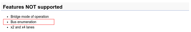

    I've found the following in the MCU+ SDK  API Guide:
    Is that stating that the MCU+ SDK doesn't support bus enumeration (even though the PCIe controller does)?
    Or is it stating the the PCIe controller itself doesn't support bus enumeration?

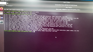

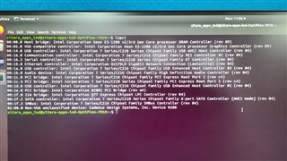

    I am going to tell what I quickly try on my side is
    Setup: Linux (Ubuntu 18.04) (working as RC) <=> AM64x (EP).
    Steps:
    • I locally build application (C:\mcu_plus_sdk\examples\drivers\pcie\pcie_buf_transfer\pcie_buf_transfer_ep) on windows PC
    • Load it to AM64x-evm board
    • Put a break point in application (to make sure PCIe should not enter into de-init).
    • Then connect PCIe cable to linux-PC
    • run lspci command to scan PCIe devices. But, It was not detected.
      • Expected as Hot Plug feature is not enabled. TRM section 12.2.2.1.2 PCIe Subsystem.
    • power cycle / Restart Linux-PC
    • run lspci command again
    • Device got detected as Cadence Design Systems

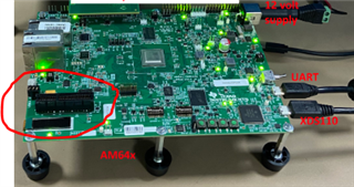

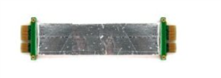

    Below is connector I used to connect PC <=> Board
    Below is PCIe slot (RED Circled) on AM64x I connected to this cable
    Below is PCIe slot (RED Circled) on PC I used for connection

  • Are the rx/tx pairs swapped in the cable?
    Is it the same cable that's used to connect two EVM boards?

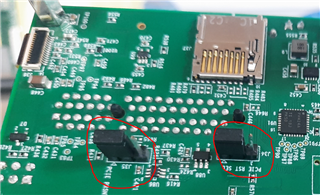

  • What position are the jumpers on J34 and J35?
    J34 and J35 positions.
    Best Regards
    Ashwani
  • Is it the same cable that's used to connect two EVM boards?
    Yes
