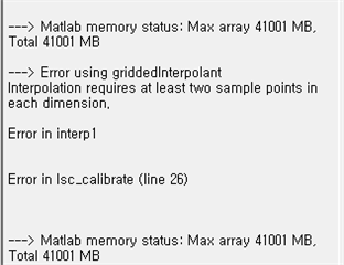

TDA4X_LSC Error
I used Tool( in DCC) to lens shading correction
I did export plug-in (With lsc lut , yuv image uploaded )
But I got an error message.
Why did that happen?
    Which version of tuning tool (ITT 2.0, 2.5 or 3.0) are you using?
    Did you follow the instructions in the LSC plugin user guide from the help menu?
    Most likely, there is something wrong with your input to ITT.
