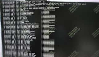

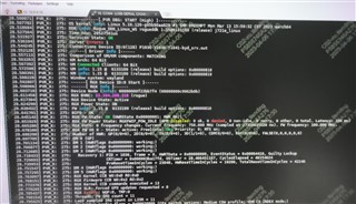

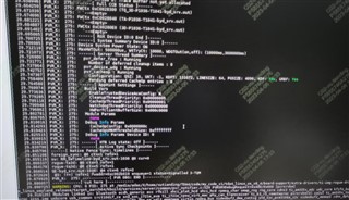

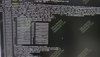

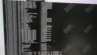

  • hi , Erick
    We have patched the driver, but the same situation still occurred during runtime. The log is attached as PVR.log. Please refer to it.
    [   40.729610] PVR_K:(Error):   253: DevicesWatchdogThread: Device status not OK!!! [500]
    [   40.739858] PVR_K:  253: ------------[ PVR DBG: START (High) ]------------
    [   40.748607] PVR_K:  253: OS kernel info: Linux 5.10.120-g95b90aa828 #1 SMP PREEMPT Sun Apr 23 12:27:10 CST 2023 aarch64
    [   40.762245] PVR_K:  253: DDK info: Rogue_DDK_Linux_WS rogueddk 1.15@6133109 (release) j721e_linux
    [   40.773626] PVR_K:  253: Time now: 40773618us
    [   40.779083] PVR_K:  253: Services State: OK
    [   40.784315] PVR_K:  253: Server Errors: 1
    [   40.789394] PVR_K:  253: Connections Device ID:0(128) P1052-V1052-T1058-byd_srv.out
    [   40.799232] PVR_K:  253: ------[ Driver Info ]------
    [   40.805437] PVR_K:  253: Comparison of UM/KM components: MATCHING
    [   40.813092] PVR_K:  253: KM Arch: 64 Bit
    [   40.818006] PVR_K:  253: UM Connected Clients: 64 Bit
    [   40.824311] PVR_K:  253: UM info: 1.15 @  6133109 (release) build options: 0x80000810
    [   40.834153] PVR_K:  253: KM info: 1.15 @  6133109 (release) build options: 0x00000810
    [   40.844315] PVR_K:  253: Window system: wayland
    [   40.849985] PVR_K:  253: ------[ RGX Device ID:0 Start ]------
    [   40.857262] PVR_K:  253: ------[ RGX Info ]------
    [   40.863196] PVR_K:  253: Device Node (Info): 00000000937b90b9 (00000000176514d9)
    [   40.872442] PVR_K:  253: RGX BVNC: 22.104.208.318 (rogue)
    [   40.879239] PVR_K:  253: RGX Device State: Active
    [   40.885472] PVR_K:  253: RGX Power State: ON
    [   40.890854] PVR_K:  253: FW info: 1.15 @  6133109 (release) build options: 0x80000810
    [   40.901234] PVR_K:  253: BIF0 - OK
    [   40.908274] PVR_K:  253: RGX FW State: FAULT - Idling (HWRState 0x00000001: HWR OK;)
    [   40.920628] PVR_K:  253: RGX FW Power State: RGXFWIF_POW_IDLE (APM disabled: 0 ok, 0 denied, 0 non-idle, 0 retry, 0 other, 0 total. Latency: 100 ms)
    [   40.941548] PVR_K:  253: RGX DVFS: 0 frequency changes. Current frequency: 600.000 MHz (sampled at 40574246045 ns). FW frequency: 100.000 MHz.
    [   40.957555] PVR_K:  253: RGX FW OS 0 - State: active; Freelists: Ok; Priority: 0; MTS on;
    [   40.967798] PVR_K:  253: FW Fault 1: "Unknown Client CCB command" (firmware/rgxfw_client_ccb.c:499)
    [   40.979093] PVR_K:  253:             Data = 0xc0028300, CRTimer = 0x00000465d14b, OSTimer = 40.496479102
    [   40.990939] PVR_K:  253: FW Fault 2: "Unknown Client CCB command" (firmware/rgxfw_client_ccb.c:499)
    [   41.002277] PVR_K:  253:             Data = 0xc0028300, CRTimer = 0x00000465d1f8, OSTimer = 40.496552915
    [   41.014138] PVR_K:  253: FW Fault 3: "Unknown Client CCB command" (firmware/rgxfw_client_ccb.c:499)
    [   41.025434] PVR_K:  253:             Data = 0xc0028300, CRTimer = 0x00000465d295, OSTimer = 40.496619902
    [   41.037280] PVR_K:  253: FW Fault 4: "Unknown Client CCB command" (firmware/rgxfw_client_ccb.c:499)
    [   41.048607] PVR_K:  253:             Data = 0xc0028300, CRTimer = 0x00000465d311, OSTimer = 40.496672808
    [   41.060466] PVR_K:  253: FW Fault 5: "Unknown Client CCB command" (firmware/rgxfw_client_ccb.c:499)
    [   41.071768] PVR_K:  253:             Data = 0xc0028300, CRTimer = 0x00000465d3c6, OSTimer = 40.496750035
    [   41.083743] PVR_K:  253: FW Fault 6: "Unknown Client CCB command" (firmware/rgxfw_client_ccb.c:499)
    [   41.095042] PVR_K:  253:             Data = 0xc0028300, CRTimer = 0x00000465d444, OSTimer = 40.496803795
    [   41.106893] PVR_K:  253: FW Fault 7: "Unknown Client CCB command" (firmware/rgxfw_client_ccb.c:499)
    [   41.118185] PVR_K:  253:             Data = 0xc0028300, CRTimer = 0x00000465d76f, OSTimer = 40.497149878
    [   41.130031] PVR_K:  253: FW Fault 8: "Unknown Client CCB command" (firmware/rgxfw_client_ccb.c:499)
    [   41.141325] PVR_K:  253:             Data = 0xc0028300, CRTimer = 0x00000465d7c2, OSTimer = 40.497185291
    [   41.153194] PVR_K:  253: Number of HWR: GP(0/0+0), 2D(0/0+0), TA(0/0+0), 3D(1/1+0), CDM(0/0+0), RAY(0/0+0), FALSE(0,0,0,0,0,0)
    [   41.167429] PVR_K:  253: DM 0 (GP)
    [   41.171691] PVR_K:  253: DM 1 (HWRflags 0x00000000: working;)
    [   41.178866] PVR_K:  253: DM 2 (HWRflags 0x00000000: working;)
    [   41.186046] PVR_K:  253: DM 3 (HWRflags 0x00000000: working;)
    [   41.193226] PVR_K:  253:   Recovery 1: PID = 1052, frame = 0, HWRTData = 0x00000000, EventStatus = 0x00000400, Guilty Lockup
    [   41.207230] PVR_K:  253:               CRTimer = 0x000004683b07, OSTimer = 40.563952224, CyclesElapsed = 40139008
    [   41.220054] PVR_K:  253:               PreResetTimeInCycles = 23296, HWResetTimeInCycles = 20224, TotalResetTimeInCycles = 43520
    [   41.234494] PVR_K:  253: DM 4 (HWRflags 0x00000000: working;)
    [   41.241674] PVR_K:  253: DM 5 (HWRflags 0x00000000: working;)
    [   41.248855] PVR_K:  253: RGX Kernel CCB WO:0x14 RO:0x14
    [   41.255380] PVR_K:  253: RGX Firmware CCB WO:0x4 RO:0x4
    [   41.261897] PVR_K:  253: RGX Kernel CCB commands executed = 20
    [   41.269181] PVR_K:  253: RGX SLR: Forced UFO updates requested = 0
    [   41.276898] PVR_K:  253: RGX Errors: WGP:0, TRP:0
    [   41.282774] PVR_K:  253: Thread0: FW IRQ count = 13
    [   41.288867] PVR_K:  253: Last sampled IRQ count in LISR = 13
    [   41.295956] PVR_K:  253: FW System config flags = 0x00020000 (Ctx switch options: Medium CSW profile; VDM CS INDEX mode;)
    [   41.309643] PVR_K:  253: FW OS config flags = 0x0000000F (Ctx switch: TDM; TA; 3D; CDM;)
    [   41.319752] PVR_K:  253: ------[ RGX registers ]------
    [   41.326179] PVR_K:  253: RGX Register Base Address (Linear):   0x00000000d5b22453
    [   41.335528] PVR_K:  253: RGX Register Base Address (Physical): 0x4E20000000
    [   41.344229] PVR_K:  253: CORE_ID                       : 0x0000000008470000
    [   41.352922] PVR_K:  253: CORE_REVISION                 : 0x00D0013E
    [   41.360751] PVR_K:  253: DESIGNER_REV_FIELD1           : 0x00000000
    [   41.368572] PVR_K:  253: DESIGNER_REV_FIELD2           : 0x00000000
    [   41.376408] PVR_K:  253: CHANGESET_NUMBER              : 0x0000000000000000
    [   41.385109] PVR_K:  253: CLK_CTRL                      : 0x0aaaaa002a2aaaaa
    [   41.393818] PVR_K:  253: CLK_STATUS                    : 0x0000000000600000
    [   41.402517] PVR_K:  253: CLK_CTRL2                     : 0x0000000000000000
    [   41.411868] PVR_K:  253: CLK_STATUS2                   : 0x0000000000000000
    [   41.420613] PVR_K:  253: EVENT_STATUS                  : 0x00004410
    [   41.428508] PVR_K:  253: TIMER                         : 0x0000000004813b4e
    [   41.437265] PVR_K:  253: BIF_FAULT_BANK0_MMU_STATUS    : 0x00000000
    [   41.445202] PVR_K:  253: BIF_FAULT_BANK0_REQ_STATUS    : 0x0000000000000000
    [   41.453930] PVR_K:  253: BIF_FAULT_BANK1_MMU_STATUS    : 0x00000000
    [   41.461811] PVR_K:  253: BIF_FAULT_BANK1_REQ_STATUS    : 0x0000000000000000
    [   41.470530] PVR_K:  253: BIF_MMU_STATUS                : 0x00000000
    [   41.478427] PVR_K:  253: BIF_MMU_ENTRY                 : 0x00000000
    [   41.486276] PVR_K:  253: BIF_MMU_ENTRY_STATUS          : 0x0000000000000000
    [   41.495018] PVR_K:  253: BIF_STATUS_MMU                : 0x00000000
    [   41.502853] PVR_K:  253: BIF_READS_EXT_STATUS          : 0x00000000
    [   41.510745] PVR_K:  253: BIF_READS_INT_STATUS          : 0x00000000
    [   41.518584] PVR_K:  253: BIFPM_STATUS_MMU              : 0x00000000
    [   41.526458] PVR_K:  253: BIFPM_READS_EXT_STATUS        : 0x00000000
    [   41.534303] PVR_K:  253: BIFPM_READS_INT_STATUS        : 0x00000000
    [   41.542262] PVR_K:  253: BIF_CAT_BASE_INDEX            : 0x0000000000000100
    [   41.550988] PVR_K:  253: BIF_CAT_BASE0                 : 0x0000000000000000
    [   41.559745] PVR_K:  253: BIF_CAT_BASE1                 : 0x00000008abf34000
    [   41.568456] PVR_K:  253: BIF_CAT_BASE2                 : 0x0000000000000000
    [   41.577210] PVR_K:  253: BIF_CAT_BASE3                 : 0x0000000000000000
    [   41.585916] PVR_K:  253: BIF_CAT_BASE4                 : 0x0000000000000000

    [   44.905196] ------------[ cut here ]------------
    [   44.911042] WARNING: CPU: 1 PID: 253 at /home/hhw3516496/workspace/TDA4_1018/tda4_linux_os_v8_4/board-support/extra-drivers/ti-img-rogue-driver-1.15.6133109/binary_j721e_linux_wayland_release/target_aarch64/kbuild/services/server/common/pvr_notifier.c:529 PVRSRVDebugRequest+0x4d0/0x660 [pvrsrvkm]
    [   44.943770] Modules linked in: bluetooth ecdh_generic ecc rfkill xhci_plat_hcd xhci_hcd cdns3 udc_core roles ti_am335x_adc omap_rng kfifo_buf rng_core irq_pruss_intc rpmsg_char pru_rproc usbcore icss_iep usb_common crct10dif_ce snd_soc_j721e_evm ti_j721e_cpsw_virt_mac phy_can_transceiver ti_k3_r5_remoteproc ti_am335x_tscadc pruss pvrsrvkm(O) sa2ul vxd_dec vxe_enc sha512_generic videobuf2_dma_sg snd_soc_pcm3168a_i2c authenc videobuf2_dma_contig v4l2_mem2mem ti_k3_dsp_remoteproc cdns_dphy videobuf2_memops videobuf2_v4l2 snd_soc_pcm3168a virtio_rpmsg_bus videobuf2_common cdns3_ti m_can_platform m_can can_dev rti_wdt sch_fq_codel rpmsg_kdrv_switch cryptodev(O) ipv6
    [   45.016906] CPU: 1 PID: 253 Comm: pvr_device_wdg Tainted: G        W  O      5.10.120-g95b90aa828 #1
    [   45.028292] Hardware name: Texas Instruments K3 J721E SoC (DT)
    [   45.035562] pstate: 80000005 (Nzcv daif -PAN -UAO -TCO BTYPE=--)
    [   45.043119] pc : PVRSRVDebugRequest+0x4d0/0x660 [pvrsrvkm]
    [   45.050031] lr : PVRSRVDebugRequest+0x4d0/0x660 [pvrsrvkm]
    [   45.056869] sp : ffff8000123e3c80
    [   45.061005] x29: ffff8000123e3c80 x28: 0000000000000000
    [   45.067636] x27: ffff8000121b3918 x26: ffff800008d687e0
    [   45.074259] x25: ffff00082d572000 x24: 0000000000000009
    [   45.080879] x23: 0000000000000002 x22: 0000000000000000
    locFile.c_str() == ./bin/image/right.bmp[   45.087499] x21: 0000000000000000 x20: ffff00082d5720d8
    [   45.098446] x19: ffff00082d47caa0 x18: 0000000000000010
    [   45.105065] x17: 0000000000000000 x16: 0000000000000000
    [   45.111901] x15: ffff00082b5d8530 x14: 00000000000005dc
    [BSP]--> tex[1] == 7[   45.118522] x13: ffff00082b5d8530 x12: 00000000ffffffea
    [   45.127306] x11: ffff800011120430 x10: ffff8000111083f0
    [   45.133927] x9 : ffff800011108448 x8 : 0000000000017fe8
    [   45.140546] x7 : c0000000ffffefff x6 : 0000000000000001
    [   45.147382] x5 : 0000000000000000 x4 : ffff00087f9daab8
    [   45.154003] x3 : 0000000000000000 x2 : ffffffffffffff00
    [   45.160623] x1 : 0000000000000000 x0 : ffff00082bdb8c00
    [   45.167246] Call trace:
    [   45.170356]  PVRSRVDebugRequest+0x4d0/0x660 [pvrsrvkm]
    [   45.176800]  DevicesWatchdogThread_ForEachVaCb+0x108/0x158 [pvrsrvkm]
    [   45.184880]  List_PVRSRV_DEVICE_NODE_ForEach_va+0x74/0xb0 [pvrsrvkm]
    [   45.192840]  DevicesWatchdogThread+0x144/0x210 [pvrsrvkm]
    [   45.199620]  OSThreadRun+0x24/0x60 [pvrsrvkm]
    [   45.205055]  kthread+0x140/0x160
    [   45.209074]  ret_from_fork+0x10/0x34
    [   45.213527] ---[ end trace b9b2eb3c337e0984 ]---

    [   38.733246] PVR_K:  246:   `--<Empty>
    [   38.737816] PVR_K:  246: FWCtx 0xC0028040 (TA-P1026-T1032-byd_srv.out)
    [   38.745965] PVR_K:  246:   `--<Empty>
    [   38.750545] PVR_K:  246: FWCtx 0xC00280E0 (3D-P1026-T1032-byd_srv.out)
    [   38.758685] PVR_K:  246:   `--<Empty>
    [   38.763268] PVR_K:  246: ------[ RGX Device ID:0 End ]------
    [   38.770340] PVR_K:  246: ------[ System Summary Device ID:0 ]------
    [   38.778166] PVR_K:  246: Device System Power State: ON
    [   38.784583] PVR_K:  246: MaxHWTOut: 500000us, WtTryCt: 10000, WDGTOut(on,off): (10000ms,3600000ms)
    [   38.795791] PVR_K:  246: ------[ Server Thread Summary ]------
    [   38.803085] PVR_K:  246:   pvr_defer_free : Running
    [   38.809174] PVR_K:  246:     Number of deferred cleanup items : 0
    [   38.816782] PVR_K:  246:   pvr_device_wdg : Running
    [   38.822873] PVR_K:  246:   pvr_cacheop : Running
    [   38.828648] PVR_K:  246:     Configuration: QSZ: 16, UKT: -1, KDFT: 131072, LINESIZE: 64, PGSIZE: 4096, KDF: Yes, URBF: Yes
    [   38.842541] PVR_K:  246:     Pending deferred CacheOp entries : 0
    [   38.850151] PVR_K:  246: ------[ AppHint Settings ]------
    [   38.856885] PVR_K:  246:   Build Vars
    [   38.861463] PVR_K:  246:     EnableTrustedDeviceAceConfig: N
    [   38.868534] PVR_K:  246:     CleanupThreadPriority: 0x00000005
    [   38.875841] PVR_K:  246:     CacheOpThreadPriority: 0x00000001
    [   38.883137] PVR_K:  246:     WatchdogThreadPriority: 0x00000000
    [   38.890531] PVR_K:  246:     HWPerfClientBufferSize: 0x000c0000
    [   38.897923] PVR_K:  246:   Module Params
    [   38.902824] PVR_K:  246:     none
    [   38.906967] PVR_K:  246:   Debug Info Params
    [   38.912312] PVR_K:  246:     CacheOpConfig: 0x0000000c
    [   38.918722] PVR_K:  246:     CacheOpUMKMThresholdSize: 0xffffffff
    [   38.926340] PVR_K:  246:   Debug Info Params Device ID: 0
    [   38.933094] PVR_K:  246:     none
    [   38.937232] PVR_K:  246: ------[ HTB Log state: Off ]------
    [   38.944196] PVR_K:  246: ------[ Active Sync Checkpoints ]------
    [   38.951699] ------[ Native Fence Sync: timelines ]------
    [   38.958333] foreign_sync: @0 ctx=1 refs=1
    [   38.963340] sw: RM_SWTimeline-byd_srv.out-1026 @0 cur=0
    [   38.969860] rogue-ta3d: @0 ctx=3 refs=1
    [   38.974653] rogue-tq3d: @0 ctx=5 refs=1
    [   38.979441] QE-byd_srv.out-1026: @4 ctx=6 refs=2
    [   38.985196]  @3: (++) refs=1 fwaddr=0xc002b019 enqueue=1 status=Signalled 3-TQM
    [   38.994334] PVR_K:  246: ------------[ PVR DBG: END ]------------
    [   39.002056] ------------[ cut here ]------------
    [   39.007930] WARNING: CPU: 0 PID: 246 at /home/hhw3516496/workspace/TDA4_1018/tda4_linux_os_v8_4/board-support/extra-drivers/ti-img-rogue-driver-1.15.6133109/binary_j721e_linux_wayland_release/target_aarch64/kbuild/services/server/common/pvr_notifier.c:529 PVRSRVDebugRequest+0x4d0/0x660 [pvrsrvkm]
    [   39.040661] Modules linked in: bluetooth ecdh_generic ecc rfkill xhci_plat_hcd xhci_hcd rpmsg_char omap_rng ti_am335x_adc rng_core kfifo_buf cdns3 udc_core roles irq_pruss_intc pru_rproc usbcore icss_iep usb_common crct10dif_ce snd_soc_j721e_evm ti_j721e_cpsw_virt_mac phy_can_transceiver ti_am335x_tscadc pruss ti_k3_r5_remoteproc vxe_enc vxd_dec videobuf2_dma_sg v4l2_mem2mem videobuf2_dma_contig pvrsrvkm(O) ti_k3_dsp_remoteproc sa2ul videobuf2_memops videobuf2_v4l2 sha512_generic virtio_rpmsg_bus cdns_dphy authenc videobuf2_common cdns3_ti snd_soc_pcm3168a_i2c snd_soc_pcm3168a m_can_platform m_can can_dev rti_wdt sch_fq_codel rpmsg_kdrv_switch cryptodev(O) ipv6
    [   39.113805] CPU: 0 PID: 246 Comm: pvr_device_wdg Tainted: G           O      5.10.120-g95b90aa828 #1
    [   39.125195] Hardware name: Texas Instruments K3 J721E SoC (DT)
    [   39.132469] pstate: 80000005 (Nzcv daif -PAN -UAO -TCO BTYPE=--)
    [   39.140083] pc : PVRSRVDebugRequest+0x4d0/0x660 [pvrsrvkm]
    [   39.147009] lr : PVRSRVDebugRequest+0x4d0/0x660 [pvrsrvkm]
    [   39.153847] sp : ffff8000121fbc80
    [   39.157976] x29: ffff8000121fbc80 x28: 0000000000000000
    [   39.164602] x27: ffff8000120ab918 x26: ffff800008c8f7e0
    [   39.171228] x25: ffff00082c75dd00 x24: 0000000000000009
    [   39.177851] x23: 0000000000000002 x22: 0000000000000000
    [   39.184477] x21: 0000000000000000 x20: ffff00082c75ddd8
    [   39.191100] x19: ffff00082b7c0b20 x18: 0000000000000010
    [   39.197723] x17: 00000000bff2cf6a x16: 00000000c98b03fc
    [   39.204344] x15: ffff00082b54d930 x14: 00000000000003b8
    [   39.210963] x13: 0000000000000000 x12: 0000000000000000
    [   39.217585] x11: 0000000000000007 x10: 00000000000009c0
    [   39.224206] x9 : ffff8000121fbae0 x8 : ffff00082b54de20
    [   39.230827] x7 : ffff00087f9ce1c0 x6 : ffff00087f9ce140
    [   39.237449] x5 : 00000000410fd080 x4 : 0000000000f0000f
    [   39.244071] x3 : 0000000000000000 x2 : ffffffffffffff00
    [   39.250693] x1 : 0000000000000000 x0 : ffff00082c7a0900
    [   39.257316] Call trace:
    [   39.260483]  PVRSRVDebugRequest+0x4d0/0x660 [pvrsrvkm]
    [   39.266951]  DevicesWatchdogThread_ForEachVaCb+0x108/0x158 [pvrsrvkm]
    [   39.275048]  List_PVRSRV_DEVICE_NODE_ForEach_va+0x74/0xb0 [pvrsrvkm]
    [   39.283041]  DevicesWatchdogThread+0x144/0x210 [pvrsrvkm]
    [   39.289831]  OSThreadRun+0x24/0x60 [pvrsrvkm]
    [   39.295271]  kthread+0x140/0x160
    [   39.299292]  ret_from_fork+0x10/0x34
    [   39.303748] ---[ end trace e7acb1207304259d ]---

    [   70.439376] PVR_K:  972: ------------[ PVR DBG: START (High) ]------------
    [   70.446321] PVR_K:  972: OS kernel info: Linux 5.10.162-g76b3e88d56 #2 SMP PREEMPT Mon Aug 7 14:12:54 CST 2023 aarch64
    [   70.457164] PVR_K:  972: DDK info: Rogue_DDK_Linux_WS rogueddk 1.15@6133109 (release) j721e_linux
    [   70.466267] PVR_K:  972: Time now: 70466259us
    [   70.470744] PVR_K:  972: Services State: OK
    [   70.475322] PVR_K:  972: Server Errors: 0
    [   70.479341] PVR_K:  972: Connections Device ID:0(128) P1040-V1040-T1052-byd_srv.out
    [   70.486997] PVR_K:  972: ------[ Driver Info ]------
    [   70.491982] PVR_K:  972: Comparison of UM/KM components: MATCHING
    [   70.498088] PVR_K:  972: KM Arch: 64 Bit
    [   70.502029] PVR_K:  972: UM Connected Clients: 64 Bit
    [   70.507087] PVR_K:  972: UM info: 1.15 @  6133109 (release) build options: 0x80000810
    [   70.514923] PVR_K:  972: KM info: 1.15 @  6133109 (release) build options: 0x00000810
    [   70.522747] PVR_K:  972: Window system: wayland
    [   70.527281] PVR_K:  972: ------[ RGX Device ID:0 Start ]------
    [   70.533113] PVR_K:  972: ------[ RGX Info ]------
    [   70.537815] PVR_K:  972: Device Node (Info): 000000001076bab3 (000000009abc3278)
    [   70.545743] PVR_K:  972: RGX BVNC: 22.104.208.318 (rogue)
    [   70.551149] PVR_K:  972: RGX Device State: Active
    [   70.555846] PVR_K:  972: RGX Power State: ON
    [   70.560117] PVR_K:  972: FW info: 1.15 @  6133109 (release) build options: 0x80000810
    [   70.567949] PVR_K:  972: BIF0 - OK
    [   70.571360] PVR_K:  972: RGX FW State: OK (HWRState 0x00000001: HWR OK;)
    [   70.578136] PVR_K:  972: RGX FW Power State: RGXFWIF_POW_IDLE (APM disabled: 0 ok, 0 denied, 0 non-idle, 0 retry, 0 other, 0 total. Latency: 100 ms)
    [   70.591532] PVR_K:  972: RGX DVFS: 0 frequency changes. Current frequency: 749.999 MHz (sampled at 70277315700 ns). FW frequency: 100.000 MHz.
    [   70.604377] PVR_K:  972: RGX FW OS 0 - State: active; Freelists: Ok; Priority: 0; MTS on;
    [   70.612627] PVR_K:  972: Number of HWR: GP(0/0+0), 2D(0/0+0), TA(0/0+0), 3D(1/1+0), CDM(0/0+0), RAY(0/0+0), FALSE(0,0,0,0,0,0)
    [   70.624039] PVR_K:  972: DM 0 (GP)
    [   70.627447] PVR_K:  972: DM 1 (HWRflags 0x00000000: working;)
    [   70.633183] PVR_K:  972: DM 2 (HWRflags 0x00000000: working;)
    [   70.638928] PVR_K:  972: DM 3 (HWRflags 0x00000000: working;)
    [   70.644680] PVR_K:  972:   Recovery 1: PID = 1040, frame = 0, HWRTData = 0x00000000, EventStatus = 0x00004410, Guilty Lockup
    [   70.655886] PVR_K:  972:               CRTimer = 0x0000073a40bb, OSTimer = 70.331044638, CyclesElapsed = 40259840
    [   70.666143] PVR_K:  972:               PreResetTimeInCycles = 35328, HWResetTimeInCycles = 23552, TotalResetTimeInCycles = 58880
    [   70.677720] PVR_K:  972: DM 4 (HWRflags 0x00000000: working;)
    [   70.683466] PVR_K:  972: DM 5 (HWRflags 0x00000000: working;)
    [   70.689212] PVR_K:  972: RGX Kernel CCB WO:0xB RO:0xB
    [   70.694266] PVR_K:  972: RGX Firmware CCB WO:0x2 RO:0x2
    [   70.699484] PVR_K:  972: RGX Kernel CCB commands executed = 11
    [   70.705314] PVR_K:  972: RGX SLR: Forced UFO updates requested = 0
    [   70.711489] PVR_K:  972: RGX Errors: WGP:0, TRP:0
    [   70.716184] PVR_K:  972: Thread0: FW IRQ count = 12
    [   70.721058] PVR_K:  972: Last sampled IRQ count in LISR = 12
    [   70.726714] PVR_K:  972: FW System config flags = 0x00020000 (Ctx switch options: Medium CSW profile; VDM CS INDEX mode;)
    [   70.737700] PVR_K:  972: FW OS config flags = 0x0000000F (Ctx switch: TDM; TA; 3D; CDM;)
    [   70.745789] PVR_K:  972: ------[ RGX registers ]------
    [   70.750928] PVR_K:  972: RGX Register Base Address (Linear):   0x00000000b2a07528
    [   70.758403] PVR_K:  972: RGX Register Base Address (Physical): 0x4E20000000
    [   70.765359] PVR_K:  972: CORE_ID                       : 0x0000000008470000
    [   70.772314] PVR_K:  972: CORE_REVISION                 : 0x00D0013E
    [   70.778584] PVR_K:  972: DESIGNER_REV_FIELD1           : 0x00000000
    [   70.784846] PVR_K:  972: DESIGNER_REV_FIELD2           : 0x00000000
    [   70.791108] PVR_K:  972: CHANGESET_NUMBER              : 0x0000000000000000
    [   70.798070] PVR_K:  972: CLK_CTRL                      : 0x0aaaaa002a2aaaaa
    [   70.805026] PVR_K:  972: CLK_STATUS                    : 0x0000000000600000
    [   70.811980] PVR_K:  972: CLK_CTRL2                     : 0x0000000000000000
    [   70.818934] PVR_K:  972: CLK_STATUS2                   : 0x0000000000000000
    [   70.825887] PVR_K:  972: EVENT_STATUS                  : 0x00004410
    [   70.832147] PVR_K:  972: TIMER                         : 0x00000000074bd149
    [   70.839102] PVR_K:  972: BIF_FAULT_BANK0_MMU_STATUS    : 0x00000000
    [   70.845363] PVR_K:  972: BIF_FAULT_BANK0_REQ_STATUS    : 0x0000000000000000
    [   70.852317] PVR_K:  972: BIF_FAULT_BANK1_MMU_STATUS    : 0x00000000
    [   70.858589] PVR_K:  972: BIF_FAULT_BANK1_REQ_STATUS    : 0x0000000000000000
    [   70.865554] PVR_K:  972: BIF_MMU_STATUS                : 0x00000000
    [   70.871818] PVR_K:  972: BIF_MMU_ENTRY                 : 0x00000000
    [   70.878087] PVR_K:  972: BIF_MMU_ENTRY_STATUS          : 0x0000000000000000
    [   70.885045] PVR_K:  972: BIF_STATUS_MMU                : 0x00000000
    [   70.891306] PVR_K:  972: BIF_READS_EXT_STATUS          : 0x00000000
    [   70.897566] PVR_K:  972: BIF_READS_INT_STATUS          : 0x00000000
    [   70.903828] PVR_K:  972: BIFPM_STATUS_MMU              : 0x00000000
    [   70.910088] PVR_K:  972: BIFPM_READS_EXT_STATUS        : 0x00000000
    [   70.916356] PVR_K:  972: BIFPM_READS_INT_STATUS        : 0x00000000
    [   70.922626] PVR_K:  972: BIF_CAT_BASE_INDEX            : 0x0000000000000100
    [   70.929586] PVR_K:  972: BIF_CAT_BASE0                 : 0x0000000000000000
    [   70.936548] PVR_K:  972: BIF_CAT_BASE1                 : 0x00000008d21eb000
    [   70.943503] PVR_K:  972: BIF_CAT_BASE2                 : 0x0000000000000000
    [   70.950457] PVR_K:  972: BIF_CAT_BASE3                 : 0x0000000000000000
    [   70.957429] PVR_K:  972: BIF_CAT_BASE4                 : 0x0000000000000000
    [   70.964395] PVR_K:  972: BIF_CAT_BASE5                 : 0x0000000000000000
    [   70.971355] PVR_K:  972: BIF_CAT_BASE6                 : 0x0000000000000000
    [   70.978336] PVR_K:  972: BIF_CAT_BASE7                 : 0x0000000000000000
    [   70.985296] PVR_K:  972: BIF_CTRL_INVAL                : 0x00000000
    [   70.991564] PVR_K:  972: BIF_CTRL                      : 0x000000C0
    [   70.997831] PVR_K:  972: BIF_PM_CAT_BASE_VCE0          : 0x0000000000000000
    [   71.004787] PVR_K:  972: BIF_PM_CAT_BASE_TE0           : 0x0000000000000000
    [   71.011787] PVR_K:  972: BIF_PM_CAT_BASE_ALIST0        : 0x0000000000000000
    [   71.018771] PVR_K:  972: BIF_PM_CAT_BASE_VCE1          : 0x0000000000000000
    [   71.025731] PVR_K:  972: BIF_PM_CAT_BASE_TE1           : 0x0000000000000000
    [   71.032689] PVR_K:  972: BIF_PM_CAT_BASE_ALIST1        : 0x0000000000000000
    [   71.039652] PVR_K:  972: PERF_TA_PHASE                 : 0x00000000
