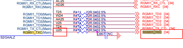

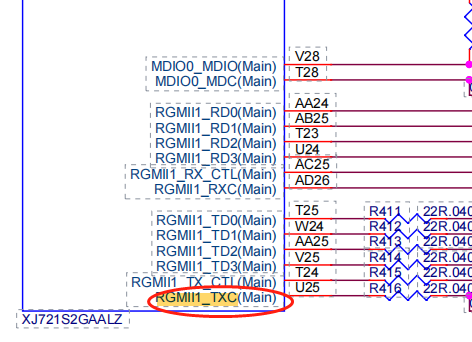

The following figure shows the pin diagram main domain:

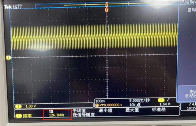

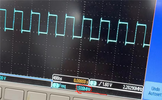

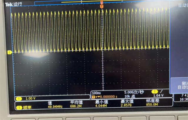

    Just adding some details:
    Output from phy to clk of Mac, the measured value is 125M:
    50M from Mac to clk, the cable removed is 10M:
    Cherry
  • Hi Cherry,
    Can you share the pin muxing used for the RGMII port?
    Please also provide the linux kernel logs.

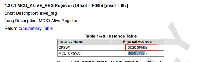

    Give some updates:
    The main domain mdio alive registers are all 0x0,? Why is this? Is the main MAC not working?
    root@j721s2-evm:~# devmem2 0x0C200F08
    /dev/mem opened.
    Memory mapped at address 0xffff977a8000.
    Read at address 0x0C200F08 (0xffff977a8f08): 0x00000000
    root@j721s2-evm:~# devmem2 0x46000F08
    /dev/mem opened.
    Memory mapped at address 0xffffaf67b000.
    Read at address 0x46000F08 (0xffffaf67bf08): 0x00000002
    The customer has confirmed that the phy is powered up normally. Connect the network cable to the computer and a DHCP discovery packet appears, but no response is received. The network cable was connected to the corporate intranet and the IP was not acquired.
    They suspect that since the Mac is not the ID of the machine, while the packet was not received after the PC and platform network cables were removed.
    Also, Is the port in the figure below turned on? (in eco sdk8.5/sdk8.6)
    Thanks and regards,
    Cherry
    The waveform on the official demo is also 10M:
    Cherry
  • Hi Cherry,
    There are some mixed observations available here.
    The MDIO Alive reg being 0 means that the CPSW is not able to detect the phy through the MDIO pins. Can you check if the MDIO pins are connected properly in the schematic and if the main MDIO node is added in the device-tree or not?
    But this contradicts with the fact that during the boot-up process you are, you are seeing the logs for ethernet c200000 with no issues in MDIO module. Even the phy is correctly detected. Are MDIO pins of some other IP being used for MAIN_CPSW?
    Can you check the internal delay setting of the Phy and make sure that it is only configured for rgmii rx internal delay. The Rgmii tx delay is enabled from MAC.

    Delay is supported by default for PHY.
    This phy model is Marvell and auto-negotiation is not supported by default. Configure phy from 1000M to 100m speed, default output TX clk is 1MHz after power on, enter the following command:
    devmem2 0x0683030 w 0x00000068
    devmem2 0x0683034 w 0x002AAAAB
    devmem2 0x0683080 w 0x00008007
    TX output becomes 2.5M:
    Static IP cannot be pinged.
    In addition, when configured as Gigabit, it is 10M after power-on, and after entering the following command, becomes TX clk 25M:
