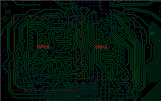

           I use VIN1A and VIN2A of TDA2SX to receive FPGA data, data bandwidth is 16bit,VIN interface uses falling edge sampling.
           Testing found that CLK=50MHz data transmission is working normally, but data transmission errors occur when CLK=100MHz.
           Other information as follows:
         (1)in file sbl_utils_tda2xx_iodelay.c ,A _ DELAY、G_ DELAY of VIN1A and VIN2A has been modified to the data in the data manual as "VIP1-MANUAL2";
            (2)  The PCB bus lengths for VIN1A and VIN2A are as follows
            unit:mil
VIN1A VIN2A
FLD0 964.38 1208.46
VSYNC0 1071.24 1296.38
DE0 1089.33 1295.65
CLK0 1177.78 1168.12
D0 1075.47 1192.82
D1 1066 1200.54
D2 1007.05 1212.45
D3 1010.52 1241.34
D4 1032.85 1164.78
D5 1060.14 1205.24
D6 1033.93 1258.54
D7 1020.63 1251.6
D8 886.92 1204.3
D9 881.83 1233.48
D10 1133.07 1214.09
D11 1143.78 1243.11
D12 951.63 1264.25
D13 942 1255.49
D14 1077.85 1231.73
D15 1070.27 1244.43
          (3)The circuit layout of the PCB is as follows
                 Is it due to incorrect software delay time configuration or hardware error,Could you please provide some suggestions for debugging issues?
  •  I made a simple mistake,in the "PROCESSOR_SDK_RADAR_03_08_00_00" SDK, CLK phase inversion during initialization of VIN1A,the code is "
    Bsp_platformSetVipClkInversion(pInstPrm->vipInstId, TRUE);", delete this code, the data transmission is working properly.
