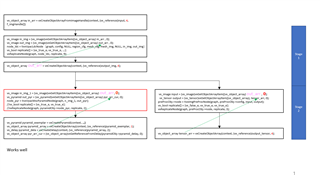

   I'm trying to design a pipeline which include 2  nodes. The first node's output  is the input of the second node.
   But the first node process 4 images, while the second node only process one of the images from the first note output.
   by this case, we just connect node 1 to node 2 , and use "replicate" in node 1 but don't use "replicate" in node, we can realize  this requirement.
   But, by this method, node 2 can only process the first image from node 1, bu we want node 2 to process the second image from node 1 array.
   Thus  we did some test, as below, seems not work well. Do you have any suggestion ?

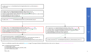

vx_image in_img_1 = (vx_image)vxGetObjectArrayItem((vx_object_array) out_arr , 0);
to extract the first image from the first node array output, the pipeline is running well.
However, When I use
vx_image in_img_1 = (vx_image)vxGetObjectArrayItem((vx_object_array) out_arr , 1);
to extract the second image from the first node's array output, the pipeline is blocked at a dequeue function.

    1. Actually, there are more than 3 nodes in my whole pipeline. I only show you the middle part in which there exists a modification( the index with blue color).
    2. We have tried to process the 4 outputs of LDC in all the nodes with replicating. And that works when we disable other pipeline. Because of the HW resource (memory resource)limitation of our system, we have to choose one image to compute the dense optical flow (showing in the left branch).

    Understood, You are sending all 4 LDC output to preproc node whereas you want to send only  vxGetObjectArrayItem((vx_object_array) out_arr , 1); to MscPyramid.
    When you are sending vxGetObjectArrayItem((vx_object_array) out_arr , 0); to MscPyramid, it works fine
    whereas if you send vxGetObjectArrayItem((vx_object_array) out_arr , 1); to MscPyramid, it doesn't work.
    Is this correct?
    If yes, I'm suspecting, this could be because how you have given the graph parameters. Could you please confirm if you have given the 0th instance or 1st instance as graph parameter ref_list for MscPyramid node? You should give the 1st instance if you want to send
