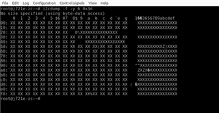

But further I'm not able to get the Deserialiser DS90UB960 data using "i2cdump -f -y 6 0x3d" command.

    What is the output of i2cdump command that you tried?
    PFA the output of the i2cdump command
    Could you please let me know in order to validate the Deseriaiser interface at linux side, which changes need to do in the device tree side.
    -Thanks and regards.
  • [ 1.210690] omap_i2c 2060000.i2c: bus 6 rev0.12 at 400 kHz
    This shows that I2C6 is probed.
    The registers of the slave device is not accessible. This means there is in intermediate mux that needs to be enabled?
    Is the I2C6 brought our correctly. Also have you configured the pinmux for I2C6_SCL & I2C6_SDA in the device tree?
