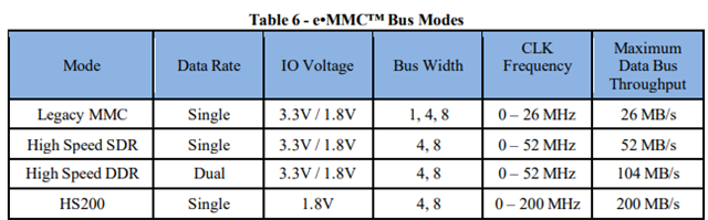

I want to integrate an eMMC in a project to save monitoring data. The TMS320C5517 work on 4.3 eMMC compliance, so it should work with eMMC 5.1
can it work at high speed SDR or just legacy mmc ?
What is the maximum supported memory size?
Is there any eMMC recerence project?
