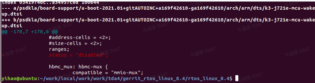

It seems that ospi flash was enabled default in Device tree: k3-j721e-mcu-wakeup.dtsi
We are using OSPI0

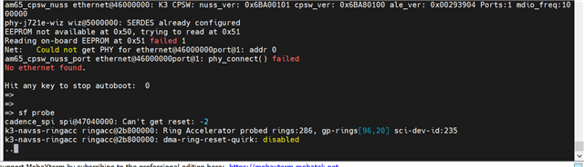

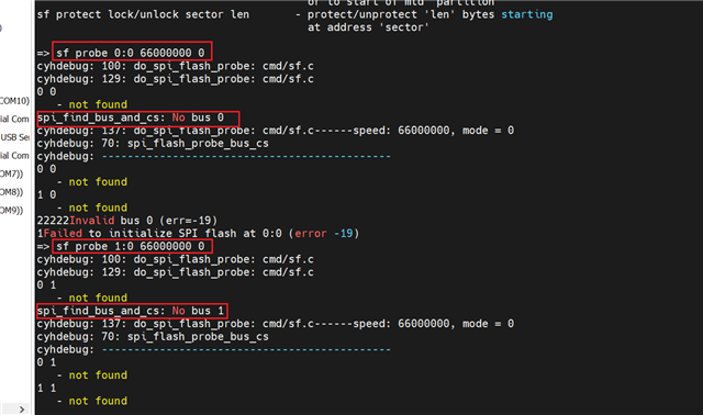

But  after the linux system boot, we got below erros:

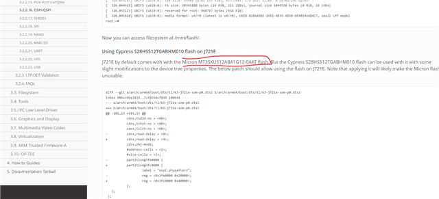

  • Hi, Keerthy,
    I found linux sdk support Mircro flash  MT35XU512ABA1G120AAT by default.
    Our hardware circuit diagram is as follows, Is there a problem with this?
    Regards.

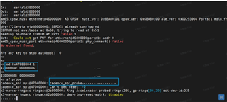

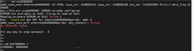

    Also please do another experiment. Please halt at U-Boot prompt and try the below command:
    sf probe
    Then see if the kernel OSPI issue is fixed.
    - Keerthy
  • Hi, Keerthy,
    If you are able to boot to kernel prompt
    No. not able to boot to kernel prompt
    sf probe
    sf probe failed.
    Log file :

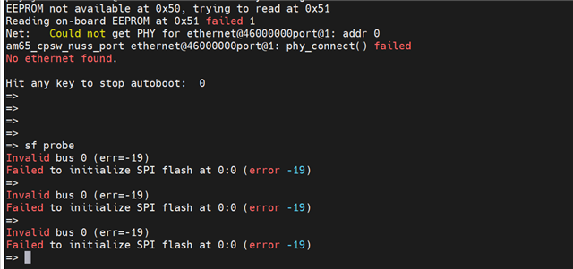

    => sf probe
    Invalid bus 0 (err=-19)
    Failed to initialize SPI flash at 0:0 (error -19)

    I Check the code and found the uboot dts node fss@47000000  disabled by mistaken before.
    below patch was the modifications what we have make in uboot:
    0001-weizhen-linux-7.1-ddr-ddr.patch.txt
    I  reenable fss@47000000 node:

    => sf probe
    cadence_spi spi@47040000: Can't get reset: -2
    k3-navss-ringacc ringacc@2b800000: Ring Accelerator probed rings:286, gp-rings[96,20] sci-dev-id:235
    k3-navss-ringacc ringacc@2b800000: dma-ring-reset-quirk: disabled
    Regards.

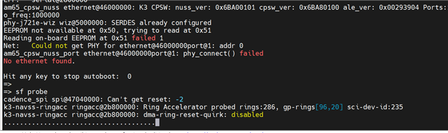

    Do you get the U-Boot command prompt back after sf probe or it hangs? I see '.................' do they stop
    or it continues to keep coming? This should ideally print something like "flash detected".
    - Keerthy
  • continues to keep coming
    '.................' keep comming.
  • This should ideally print something like "flash detected
    Hi,  I found after run sf probe, something wrong happend and block in read function.
  • .Hi, Keerthy,
    Do you have any idea of the print "...................." ?
    Regards.
  • Hi, Keerthy,
    I chase the code, and found the "....." was print by function "udma_poll_completion()",  and this function was called by udma_transfer().
    It seems that ospi norflash has encountered DMA issues during both uboot and kernel initialization. What do you think of this issue and any suggestions is highly appreciated.
    Regards.

    • share the output of the command 'md 0x47000004 1' from U-Boot.

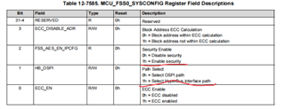

    the output is:
    BRs
  • Hi, Keerthy,
    the value of 0x47000004 is 0x6,  it seems currently select the HyperBus interface path, is this state wrong?
    BRs
    Yes so that GPIO disabling was to make sure that hyperbus was not selected. I believe after that sf Probe is working without errors. Can you confirm that? Also try booting to Linux after sf probe command is successful.
    Keerthy

    Try the below diff:
    diff --git a/arch/arm/dts/k3-j721e-mcu-wakeup.dtsi b/arch/arm/dts/k3-j721e-mcu-wakeup.dtsi
    index a5159ce9d3..c006f241e1 100644
    --- a/arch/arm/dts/k3-j721e-mcu-wakeup.dtsi
    +++ b/arch/arm/dts/k3-j721e-mcu-wakeup.dtsi
    @@ -185,19 +185,6 @@
                            mux-reg-masks = <0x4 0x2>; /* HBMC select */
    -               hbmc: hyperbus@47034000 {
    -                       compatible = "ti,j721e-hbmc", "ti,am654-hbmc";
    -                       reg = <0x0 0x47030000 0x0 0xc>,
    -                               <0x0 0x47034000 0x0 0x100>,
    -                               <0x5 0x00000000 0x1 0x0000000>;
    -                       power-domains = <&k3_pds 102 TI_SCI_PD_EXCLUSIVE>;
    -                       #address-cells = <2>;
    -                       #size-cells = <1>;
    -                       mux-controls = <&hbmc_mux 0>;
    -                       assigned-clocks = <&k3_clks 102 0>;
    -                       assigned-clock-rates = <250000000>;
                    ospi0: spi@47040000 {
                            compatible = "ti,am654-ospi";
                            reg = <0x0 0x47040000 0x0 0x100>,
    Keerthy
  • Hi, Keerthy,
    Do you have hyperflash on your custom board?
    Nop.
    I try, but not work. it was weird

  • Hi Xie,
    Can you add a print in the function: detect_enable_hyperflash() under board/ti/j721e/evm.c
    & also add a debug print to probe function in drivers/mtd/hbmc-am654.c
    - Keerthy
  • Hi, Keerthy,
    modify file
    it seems that hmbc was not get probe.
    log:

    => md 0x47000004 1
    47000004: 00000006                               ....
    47000008: 00000000                               ....
    => sf probe
    cadence_spi spi@47040000: cadence_spi_probe------------------
  • Hi Xie,
    This is not expected. The reset value of the register should not be 0x6.
    Can you check where in the boot this value gets set by adding debug prints in the OSPI driver?
    - Keerthy
