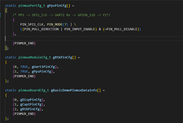

I want to config a GPIO as a Interrupt input pin in mcu2_0, and set it
GPIO_CFG_IN_INT_RISING, but I don.t know how to config it ;
Is there any Demo to this? Or document to introduce this?
  • I use the GPIO0_118 as input pin. (Y1)
    Now i have do this:
    1. in "vision_apps\utils\misc\src\app_pinmux_j721e.c",
    2. in "ethfw\utils\board\src\j721e\board_j721e_evm.c":
    3. in "pdk_jacinto_08_04_00_21\packages\ti\drv\gpio\soc\j721e\GPIO_soc.c"
     after finished this change, I rebuild the RTOS SDK, and replace the "vx_app_rtos_linux_mcu2_0.out" in"/lib/firmware/vision_apps_evm".
    But when reboot the system, the terminal doesn't print the log.
    What else I need to do ?

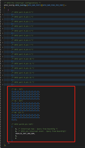

  • Thanks, I have refer that, and add the interrupt enable code; and the Trigger mode has been set successfully。But the intNum is wrong.
    in my example, I used the GPIO0_118, means gpio_port_num = 0, and pin_num = 118, and when i want to get a intNum by "GPIO_socConfigIntrPath()", it return -1; the code as below:
    int32_t GPIO_socConfigIntrPath(uint32_t portNum, uint32_t pinNum,void *hwAttrs,bool setIntrPath)
        GPIO_v0_HwAttrs   *cfg = (GPIO_v0_HwAttrs *)hwAttrs;
        if(CSL_PASS == retVal)
            /* Get the valid range of valid interrupts based on the ir_id. */
            retVal = GPIO_socGetIrqRange(ir_id, dst_id, &irq_range_start, &irq_range_num);
            if(bankNum <= irq_range_num)
                dst_host_irq = irq_range_start + bankNum;
      return(retVal);
    in the code, the irq_range_num is 4, and bankNum=7; so it return -1;
    I want know:
    1. where define the irq_range_num to be 4;
    2. How Can I get a irqnum for GPIO0_118, How to route the interrupt func;
    Can you please share what parameters are being passed to rmIRQSet in the code?
    Parth
  • HI,
    In this example, the "Sciclient_rmIrqSet()"  won't be running, because the condition “if(bankNum <= irq_range_num)” is not hold. so the retVal will be CSL_EFAIL, and return immediately。
    some parmeters as below:
    src_id = TISCI_DEV_GPIO0;
    src_index = (uint16_t)bankNum;  // GPIO0_118, bankNum = 7
    dst_id =  TISCI_DEV_R5FSS0_CORE0
    ir_id   = TISCI_DEV_R5FSS0_INTROUTER0
