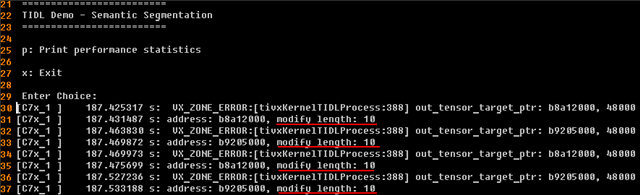

After running TIDL, shared memory is overwritten unexpectedly.
We found that shared memory will be overwritten unexpectedly when running TIDL whose last layer is argmax.
Is there any reason why shared memory is overwritten expectedly and how to prevent such memory overwritten issue?
The test environment is  TDA4 EVM, with tda4_sdk_8.4.0.6_j721e and TIDL version is tidl_j721e_8.4.0.16.
We used the test program located in vision_apps/apps/dl_demos/app_tidl_seg/  to reproduce this issue, with modified vx_tidl_target.c (file attached below)

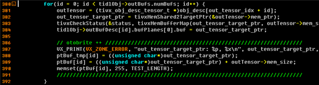

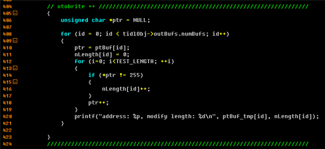

// otobrite ++ /////////////////////////////////////////////////////////////
#define TEST_LENGTH 10
static unsigned char *ptBuf[TEST_LENGTH] = {0};
static unsigned char *ptBuf_tmp[TEST_LENGTH] = {0};
static int nLength[TEST_LENGTH] = {0};

        for(id = 0; id < tidlObj->outBufs.numBufs; id++) {
            outTensor = (tivx_obj_desc_tensor_t *)obj_desc[out_tensor_idx + id];
            out_tensor_target_ptr = tivxMemShared2TargetPtr(&outTensor->mem_ptr);
            tivxCheckStatus(&status, tivxMemBufferMap(out_tensor_target_ptr, outTensor->mem_size, (vx_enum)VX_MEMORY_TYPE_HOST, (vx_enum)VX_WRITE_ONLY));
            tidlObj->outBufDesc[id].bufPlanes[0].buf = out_tensor_target_ptr;
            VX_PRINT(VX_ZONE_ERROR, "out_tensor_target_ptr: %p, %x\n", out_tensor_target_ptr, outTensor->mem_size);
            ptBuf_tmp[id] = ((unsigned char*)out_tensor_target_ptr);
            ptBuf[id] = ((unsigned char*)out_tensor_target_ptr) + outTensor->mem_size;
            memset(ptBuf[id], 255, TEST_LENGTH);
        status = tivxAlgiVisionProcess
                    tidlObj->algHandle,
                    &tidlObj->inBufs,
                    &tidlObj->outBufs,
                    (IVISION_InArgs  *)tidlObj->inArgs,
                    (IVISION_OutArgs *)tidlObj->outArgs,
                    tidlObj->tidlParams.optimize_ivision_activation
            unsigned char *ptr = NULL;
            for (id = 0; id < tidlObj->outBufs.numBufs; id++)
                ptr = ptBuf[id];
                nLength[id] = 0;
                for (i=0; i<TEST_LENGTH; ++i)
                    if (*ptr != 255)
                        nLength[id]++;
                    ptr++;
                printf("address: %p, modify length: %d\n", ptBuf_tmp[id], nLength[id]);

Our code modification and the evidence of shared memory overwritten is described as the following:
(1) To pad 10-byte data (with the value 255) at the end of the output tensor. (in attached vx_tidl_target.c, line 386~line391)
(2) Add code for check whether that extra 10-byte is modified after calling tivxAlgiVisionProcess(). (in attached_tidl_target.c, line 404~line424)
(3) Rebuild tidl and test program app_tidl_seg, then run test program app_tidl_seg.
The console showing "modify length: 10" indicates that shared memory is indeed overwritten.

  • Hi Nikhil Dasan,
    Our question is why argmax layer of TIDL causes unexpected memory overwritten and what is TI's plan to fix this issue.
    (1) To find out unexpected memory overwritten, we have narrowed down to the argmax layer.  We use segmentation demo, which contains argmax as the last layer of deep learning model, to show how this issue happens. We hope TI can based on segmentation demo to find out what's wrong inside TIDL.
    (2) Object detection demo does not contain argmax layer and of course it does not have such issue, and trying other DL demos not containing argmax layer is meaningless.
    Mark Kang.

  • Hi Anshu Jain,
    I try on SDK8.6 and find the same issue still exists.  The Argmax issue is not solved yet and your recall is totally wrong.
    Although vision_apps/apps/dl_demos/app_tidl_seg/vx_tidl_target.c  is slightly different from SDK8.4, with the similar modification (file attached below)
    #if defined(SOC_AM62A)
    #ifndef x86_64
            Cache_wbInvL1dAll();
    #endif
    #endif
                        tidlObj->algHandle,
                        &tidlObj->inBufs,
                        &tidlObj->outBufs,
    #ifndef x86_64
    #endif
    #endif
                    ptr = ptBuf[id];
                    nLength[id] = 0;
                        if (*ptr != 255)
                            nLength[id]++;
                        ptr++;

    After running the demo program orginated from  vision_apps/apps/dl_demos/app_tidl_seg/  , the console still shows "modify length: 10". The shared memory is still overwritten unexpectedly.
