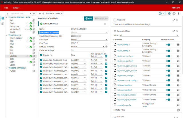

I am using a custom design with a AM62A processor.
It is configured for MMCSD Boot mode connected to MMC1.
I want to change the example bootloader "sbl_emmc_linux_stage1_am62ax-sk_r5ss0-0_nortos_ti-arm-clang" to use MMC1 for loading the other cores.
However, when using the syscfg tool, I cannot change the emmc driver to a configuration that uses MMC1.
How can I change the bootloader to use MMC1?
Thanks and best regards, Katharina

  • Hi Katharina,
    Apologies for the delay in response.
    I believe you are talking about the "Select MMCSD Module" field being locked as shown
    If so, you can directly make the changes in the files generated by Syscfg to use & configure MMC1. The process is:

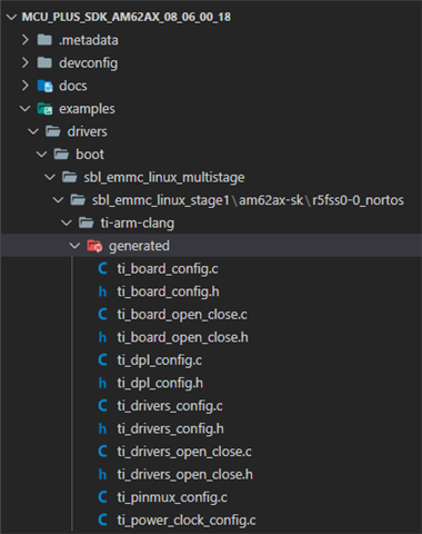

    • Build the example as it is. The Syscfg will generate automatic files at the location shown below
    • Do the below change in the makefile to prevent overwriting of the automatic files by Syscfg.

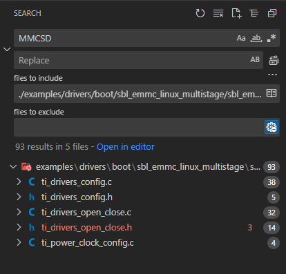

    • Do the necessary changes in files containing MMCSD related code. I would recommend to search MMCSD in the folder named generated as shown below to see the places where MMCSD is being used and then accordingly do the necessary changes.
    • Build the example with all the changes.
