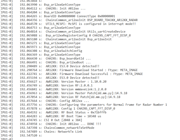

The customer has made the custom board referenced routine 4, Radar (Single AWR1243) Capture + Radar Object detect (EVE1) + Null (TDA3xx only) from the TDA3EVM schematic.

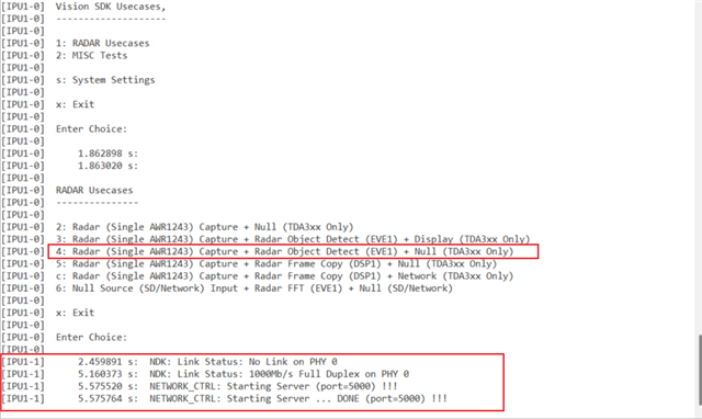

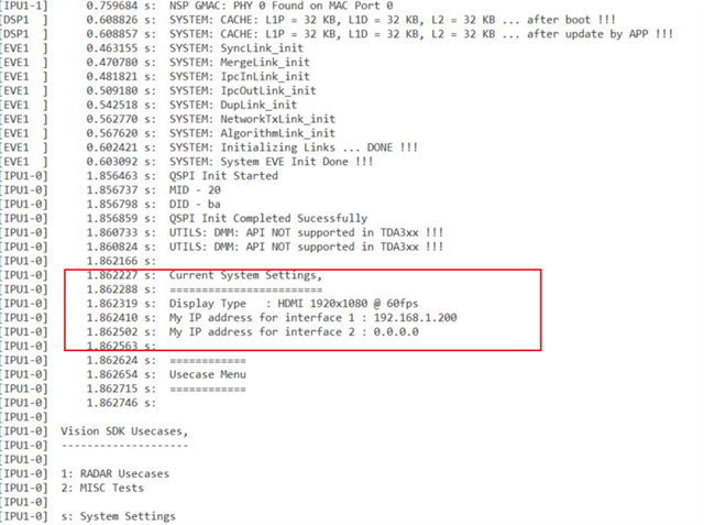

Issue: Ping 192.168.1.200 cannot access the target host.
Below is the log of the serial output:
The usecase selected is Radar (Single AWR1243) Capture + Radar Object detect (EVE1) + Null (TDA3xx only). Based on the output information, the program shows that the network service is working properly, but it captures packets with wireshark without any information. Is it a program configuration or hardware issue?

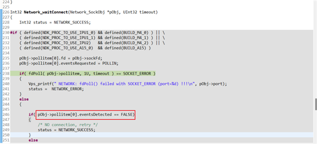

Also, EventsDetected is always 0, and is always cycled in the "wait for Connection" function. Where is this parameter assigned?
