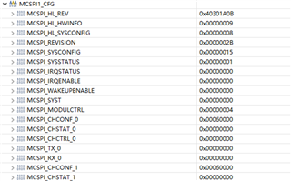

  • Hi Brijesh,
    1、Our SPI uses TX and RX.
    2、By comparison, we find that the registers of MCSPI are invariant when TIDL is running and when TIDL is not running.
    Before running TIDL:
    After running TIDL:
    3、SPI DMA runs on R5F core (MCU1_0)
    4、We can only confirm that TIDL has no effect on MCSPI when MCSPI does not use DMA, and that MCSPI will not work when the TIDL program is run while MCSPI uses DMA. DMA channel conflicts are just our guesses.
    bingxian

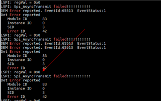

  • Hi Brijesh,

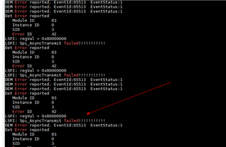

    Because of the complexity of the problem, we did a careful check again,We find that DMA is not the cause of the problem.
    We cyclically send the SPI signal at MCU1_0 at a rate of 1ms,When we are not running A72 APP, MCSPI1 sends and receives everything as expected.
    Then we run our APP on A72 (avp_master.out), at which point MCU1_0 will print MCSPI1 send error:
    We find that this error is SPI busy error.
    Our APP(avp_master.out) mainly has functions about TIDL, AVM, coding and decoding. According to our current investigation situation, we cannot know why MCSPI1 is affected by APP.
    bingxian

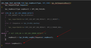

  • Hi Brijesh,
    We are using the driver from MCAL.
    The MCAL SPI.c function Spi_GetSequenceResult returns a value sometimes SPI_SEQ_PENDING, which causes an SPI transfer error.
    Spi_GetSequenceResult always returns SPI_SEQ_OK when A72 is not running app(avp_master.out).
    Spi_GetSequenceResult sometimes returns SPI_SEQ_PENDING after running app(avp_master.out)
    The Spi_GetSequenceResult function is as follows:
    bingxian
  • Hi bingxian,
    Sorry, not much familiar with the MCAL driver, can you please check where seqResult variable is set?
    Brijesh
  • Hi Brijesh,
    The seqResult variable is set to SPI_SEQ_OK only when initialized and when the SPI DMA sends an interrupt.
    We feel that after running the app(avp_master.out), the SPI DMA interrupt is sometimes not generated

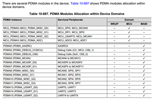

    Is your application using any DMA channel from MCU domain? If not, that's surprising that it works after application is started.
    Brijesh
  • Hi Brijesh,
    Our app on the A72 also does not use the DMA channel to the MCU domain.
    According to the manual, MCU_PDMA1 only serve MCSPI1 and MCSPI2, the problem we have should not be a problem with DMA being occupied.
    bingxian

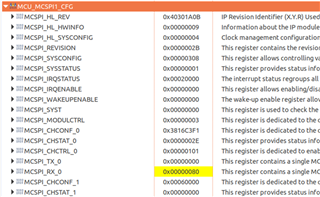

    Thanks for sharing the logs as requested.
    I have looked into the log of registers which you have shared earlier, MCSPI_MODULCTRL=0x4 in both the cases.
    Which indicates it is in Slave Mode.
    .Is it MASTER or SLAVE mode on TDA4VM side for McSPI?
               is MASTER .
    But you have mentioned it to be in Master Mode.MCAL driver supports only Master mode.
    And also all the Tx and Rx registers are no showing no data transfer.
    Kindly request to share the register dump exactly at point when McSPI- DMA is working(transferring data) vs McSPI-DMA + APP not working.
    Tarun Mukesh

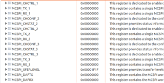

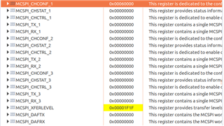

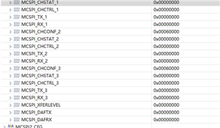

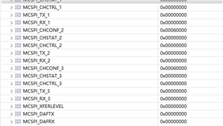

  • Hi Tarun Mukesh,
    Sorry, I read the wrong register before.
    MCU_MCSPI1 correct register status is as follows:
    Before running the A72 app:
    After running the A72 app:
    bingxian

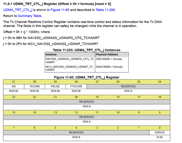

  • Hello Bingxian,
    We are looking into the issue thoroughly and trying to narrow down the possible deviations.

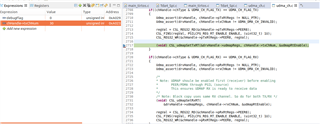

    In Udma_chEnableLocal() API ,can you please keep a break point at
    CSL_udmapSetTxRT(&drvHandle->udmapRegs, chHandle->txChNum, &udmapRtEnable);
    and share me the details of txChNum value ?
    Tarun Mukesh
  • Hi Tarun Mukesh,
    txChNum has a value of 30
    bingxian

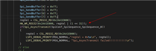

    As the txChNum =30 , Can you please share me the register dump at 0x2AA1E000 location during non working(failed) scenario?
    Tarun Mukesh
  • Hi Tarun Mukesh,
    I print out the register value when MCU_MCSPI1 transmission error with a value of 0x00.
    Since it is not easy to get incorrect results when debugging with CCS, we can only print out the register value when there is an error.
    bingxian
  • Hello Bingxian,
    Thanks for sharing ,from the above we are able to understand UDMA channel is not getting enabled.
    when McSPI is unable to transmit and during this hung condition then can you connect CCS and see register dump at 0x2AA1E000 value is same as you sent .if it the same can you make 0x2AA1E000 = 0x80000000 (Set the 31st bit )
    and then see McSPI able to transmit
    Tarun Mukesh
  • Hi Tarun Mukesh,
    1.I can't find a description of the register 0x2AA1E000 in the data sheet, what kind of register is this register?
    2.I set bit 31 of this register to 1 before sending, but I still get an SPI transmission error.
    3.We also found a situation: after we changed the MCU_MCSPI1 transmission period from 1ms to 10ms MCU_MCSPI1 no transmission error was reported.
    bingxian
    The register is from the picture above,as you are using channel 30 the offset is calculated and 0x2AA1E000 is the address.
    The UDMA channel is not getting enabled ,once it enables then only we can have previous data transmit changes from pending to done and starts new data transmission.
    Please use CCS tool to write the value into the register .When you are facing the failed scenario connect CCS and write the value provided into the location.
    Tarun Mukesh
  • Hi Tarun Mukesh,
    I use CCS to put a breakpoint on the MCU_MCSPI1 transmission error, and I write 1 on bit 31 of the register 0x2AA1E000 when there is a transmission error. But I observed with an oscilloscope MCU_MCSPI1_CLK there was no waveform output.
    I also tried calling the write register function on SPI transmission error HW_WR_REG32_RAW writing 31 bits of register 0x2AA1E000 to 1, but I observed that MCU_MCSPI1_CLK also had no waveform output.
    bingxian
