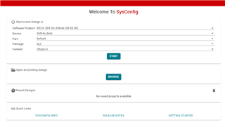

With current Code Composer Studio 12 and Sysconfig 1.15, MCU+SDK 08.05 as well as on the Cloud, when I try to add a CPSW for an AM64x, I see this error
Hi Michel,
It seems that MCU+SDK 08.05 is not compatible with the SysConfig v1.15, but it is compatible with the SysConfig v1.14.0. Can you please try to add CPSW instance with SysConfig v1.14.0. The same version is recommended in SDK documentation also.
