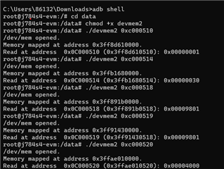

Dear ti,
Our customer board config port as following:
serdes1-> sgmii1/sgmii2/sgmii3/sgmii4
serdes2->sgmii5/sgmii6/sgmii7/sgmii8
is the serdes1 and serdes2 the refclk is internal or external clk by default in dts?
how to set the internal refclk ?
please guide us how to config serdes port correctly, thanks

  • Dear TI,
    when set the QSGMII mode,can found the phy link up, but don‘t ping ip address
    but when we set the SGMII mode, cant found the eth3/ eth4 /eth5/eth6 node, the SGMII mode log  is :
    the error source code:

  • Dear ti,
    Does this register can use detect the sgmii link status?
  • Yes, bit 0 indicates link up. BTW, i'm afraid that you're not looking into a TRM for TDA4VH, please double check on it. thanks.
  • Dear xu,
    can you help to send a TRM for TDA4VH? thanks
  • you can download all docs and app notes from ti.com
    https://www.ti.com/product/TDA4VH-Q1#tech-docs
  • Dear ti,
    Thanks, we dump the register , the value is 0x0, that is no link, right? the issue is cpsw sgmii not set coreectly?
    32 78h CPSW_NUSS_VBUSP cpsw_9xuss_j7am_STATUS_SGMII_LINK_REG 0h SGMII Link Status Register
    32 78h CPSW_NUSS_VBUSP cpsw_9xuss_j7am_STATUS_SGMII_LINK_REG   RESERVED NONE 0h Reserved
    32 78h CPSW_NUSS_VBUSP cpsw_9xuss_j7am_STATUS_SGMII_LINK_REG 1 SGMII2_LINK R 0h Port 2 SGMII Link Indicator
    32 78h CPSW_NUSS_VBUSP cpsw_9xuss_j7am_STATUS_SGMII_LINK_REG 0 SGMII1_LINK R 0h Port 1 SGMII Link Indicator
  • Dear TI,
    the port 5 register value is 0x00000032
    root@j784s4-evm:/data# ./devmem2 0xc000514
    /dev/mem opened.
    Memory mapped at address 0x3ff9ff50000.
    Read at address 0x0C000514 (0x3ff9ff50514): 0x00000032

    the patch 0724.add-sgmii-support-j784s4.patch is also failed
  • when add the 0724.add-sgmii-support-j784s4.patch in the linux, the register dump is:

  • Hi Tanmay,
    We found the linux native driver SGMII link failed , caused by serdes2 config
    1)add the RTOS serdes config
         * serdes 2
        memset(&serdesLaneEnableParams, 0, sizeof(serdesLaneEnableParams));
        serdesLaneEnableParams.serdesInstance    = (CSL_SerdesInstance)CSL_TORRENT_SERDES2;
        serdesLaneEnableParams.baseAddr          = CSL_WIZ16B8M4CT3_2_WIZ16B8M4CT3_BASE;
        serdesLaneEnableParams.refClock          = CSL_SERDES_REF_CLOCK_100M;
        serdesLaneEnableParams.refClkSrc         = CSL_SERDES_REF_CLOCK_INT0;
        serdesLaneEnableParams.linkRate          = CSL_SERDES_LINK_RATE_1p25G;
        serdesLaneEnableParams.numLanes          = numLanes;
        serdesLaneEnableParams.laneMask          = laneMask;
        serdesLaneEnableParams.SSC_mode          = CSL_SERDES_NO_SSC;
        serdesLaneEnableParams.phyType           = CSL_SERDES_PHY_TYPE_SGMII;
        serdesLaneEnableParams.operatingMode     = CSL_SERDES_FUNCTIONAL_MODE;
        serdesLaneEnableParams.phyInstanceNum    = BOARD_SERDES_LANE_SELECT_CPSW;
        serdesLaneEnableParams.pcieGenType       = CSL_SERDES_PCIE_GEN3;
        for (laneNum = 0; laneNum < numLanes; laneNum++) {
            serdesLaneEnableParams.laneCtrlRate[laneNum] = CSL_SERDES_LANE_FULL_RATE;
            serdesLaneEnableParams.loopbackMode[laneNum] = CSL_SERDES_LOOPBACK_DISABLED;
        CSL_serdesPorReset(serdesLaneEnableParams.baseAddr);
            /* Select the IP type, IP instance num, Serdes Lane Number */
            CSL_serdesIPSelect(CSL_CTRL_MMR0_CFG0_BASE,
