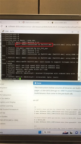

I have designed my Custom Am62x Board , however , the emmc couldnt work , the log is shown as the attachment  .
shall I format & partition the eMMc first ?
What is the SW procedure for a new eMMC (not being format and partition yet) on Custom Am62x Board ?

  • Dear Bin ,
    please see the log as the attachment . AM62x EVM used MTFC16GAPALBH-IT type of eMMC and my custom Board uses  MTFC16GAPALBH-AAT .
    Does it  need do any change on U-boot setting for the different type of number ?
    Jack Wang
