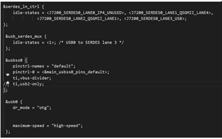

The following is the configuration of the SerDes port in use set up by a customer.
Their problem is that SERDES1,2(Ethernet) and SEDES3(USB3.0) are bring up, respectively, so there is no problem with the operation.
However, only USB 3.0 can be used when SERDES1,2,3 (Ethernet and USB 3.0) are bring up, and Ethernet cannot be seen on linux, and it seems to be linked up
It seems that the link up check is not working properly in Ethernet Firmware.
Please reply to the following.
1) USB 3.0 and SGMII (2 ports) can operate simultaneously
2) Where to check if simultaneous operation is possible
The followings are for the kernel configuration.
and Ethernet will work normally when you delete the usb-related code from the kernel.
The following is for Ethernet configuration.

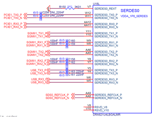

  • As shown in the figure above, LANE2,3 SGMII 1000BASET1 is used instead of QSGMII.
    &serdes_ln_ctrl {
    	idle-states = <J7200_SERDES0_LANE0_IP4_UNUSED>, <J7200_SERDES0_LANE1_QSGMII_LANE4>,
    		      <J7200_SERDES0_LANE2_QSGMII_LANE1>, <J7200_SERDES0_LANE3_USB>;
    &serdes0 {
    		#address-cells = <1>;
            #size-cells = <0>;
    		serdes0_sgmii_link: phy@1 {
    			reg = <1>;
    			cdns,num-lanes = <2>;
    			#phy-cells = <0>;
    			cdns,phy-type = <PHY_TYPE_SGMII>;
    			resets = <&serdes_wiz0 2> , <&serdes_wiz0 3>;
    As far as I know, ethernet firmware also sets up SERDES.
    So I set it up like above in order not to set it up in the kernel over there.
    I've tried both settings to solve this problem, but only one of SGMII or USB 3.0 works.
    Can I use SGMII and USB 3.0 at the same time?
  • The SERDES connection of our board is as follows.

    [JACK]
    We identified that QSGMII and USB 3.0 are working simultaneously with the patch you provided. The Custom Board uses SGMII instead of QSGMII, so I'll ask you separately.
    3.Help share the full boot up logs which is having issue.
    [JACK] SGMII & USB3 failure log attached observed on top of Custom board.
