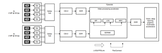

We have some questions about TI TDA4VM ECO and TDA4ALow,
Whether the two devices support simultaneous input of eight 2m cameras
Please help us to sovle these cases

Hi daohong qin,
I think they can, but it depends also on bits per pixel and fps.. Please refer to the device datasheet for more information on CSIRX support.
Brijesh
hi,
Ub960 is external deserializer that can be connected to TDA4 over CSI2 interface.. So since there are two CSIRX ports, yes, two ub960 can be connected to TDA4VMEco.

Hi TI Experts,
If I need to use TDA4VM eco input, a total of 8 cameras of 2.5m(1920*1280), including 4 round-view and 4 side-view,
what type of deserializer board should I use,
Best Regards
Hi
You could use 2 instances of UB960 to support 8 camera of 1920x1280 resolution. This is available on Fusion board..
Brijesh
