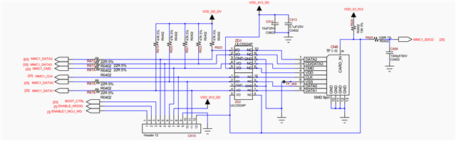

our v1.0-board,system startup is normal, no error;
new v1.1-board, the mmc circuit is unchanged,but mmc1 repeated error

Cesar
  • new v1.1-board, the mmc circuit is unchanged,but mmc1 repeated error
    Could you describe the hardware change for us to better understand?
    Couple of more questions:
    • Also have you tried with a different SD card?
    • Which SDK version are you trying?
    • So the same SD card works on 1.0 revision board and fails like above on the 1.1 board. Can you confirm?
    - Keerthy

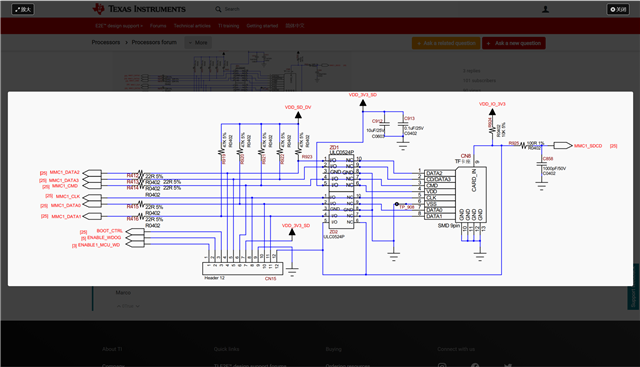

  • Hi Keerthy,
    1."Could you describe the hardware change for us to better understand?"
    reply: The sd card cable routing is different
    3.the QiLi card runs normally on both boards;
    Cesar

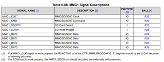

  • Hi Cesar,
    Could you share your working v1.0 MMC1 schematic to note what was changed?
    You have PU resistors on the DATA pins which are not specified in the datasheet, and it appears you have MMC1_DAT3 and MMC1_SDCD tied to the same post which can cause issues with boot especially.
    Marco
  • Hi Marco,
    1. Could you share your working v1.0 MMC1 schematic to note what was changed?
     reply: The schematics of the two versions remain unchanged
    Cesar

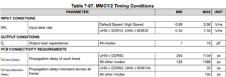

  • You mentioned that "The sd card cable routing is different" on V1.1. Could you have violated any of the given timing conditions with the new routing?
    Does any SanDisk card fail on your v1.1 board, or just one particular card? This card may have been marginally passing on your v1.0 board, and the new routing could be causing it to fail.
