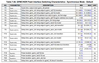

My customer is developing the interface logic of FPGA for AM5726 with GPMC.
FPGA uses clkout1 output by AM5726 as its operating clock.
When GPMC_CLK_MUXMODE of CTRL_CORE_PAD_GPMC_CLK
[3:0] is set to 0x2
1. They would like to know the synchronization relationship and phase relationship between clkout1 and GPMC_CLK.
2.  Which clock source is clkout1 generated from?
The above information is required for timing design on the FPGA side.

  • Hi T. Sakuma,
    Please see the Datasheet Signal Descriptions for GPMC (specifically notes 1 and 2 on the CLK signal):
    Timing information on using CLKOUT1 as a GPMC reference clock can be found in Table 7-26/7-28 (also linked in Signal Descriptions above):
    As for the source of CLKOUT1:
    Marco
