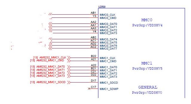

Dear Champs,
My customer is working to bring-up their custom board and succeed to boot-up using OSPI flash memory, but faced stuck on SD Card with below log.
Could you please check below log and provide your opinion what should be checked?
ERROR:   Unhandled External Abort received on 0x80000000 from S-EL1
ERROR:   exception reason=1 syndrome=0x92000010
Unhandled Exception from EL1
Full log is as below.

i2c_write: error waiting for data ACK (status=0x116)
pca953x gpio@22: Error reading output register
U-Boot 2021.01 (Apr 19 2023 - 09:26:20 +0900)
SoC:   AM62X SR1.0 GP
Model: Texas Instruments AM625 SK
Timed out in wait_for_event: status=0000
Check if pads/pull-ups of bus are properly configured
EEPROM not available at 0x50, trying to read at 0x51
Reading on-board EEPROM at 0x51 failed 1
DRAM:  2 GiB
MMC:   mmc@fa10000: 0, mmc@fa00000: 1, mmc@fa20000: 2
Loading Environment from MMC... Card did not respond to voltage select! : -110
*** Warning - No block device, using default environment
In:    serial@2800000
Out:   serial@2800000
Err:   serial@2800000
Net:   Could not get PHY for ethernet@8000000port@1: addr 0
am65_cpsw_nuss_port ethernet@8000000port@1: phy_connect() failed
switch to partitions #0, OK
mmc1 is current device
SD/MMC found on device 1
Failed to load 'boot.scr'

They connected SD card to mmc1 and I also attached their HW schematic in below.
