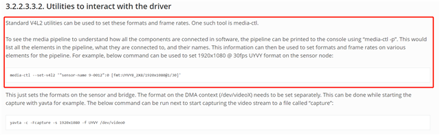

thank you for your help, I have one more question:
Can you just use this code to capture it?
the 'media-ctl' ,do I need to operate?
Cesar
Hi Cesar,
The media-ctl is to used when you have to set the formats of each stages or to set the routes from one stage to another.
Is all these are set prior, you could directly proceed with the yavta command.

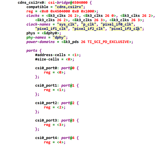

dts is unchanged, official.
Cesar

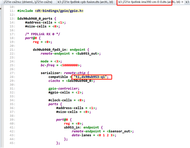

The ub953 does not match the device tree.
1.DTS
2.uEnv.txt
name_overlays=k3-j721e-fpdlink-cpb-fusion.dtbo k3-j721e-fpdlink-imx390-cm-0-0.dtbo
3. ds90ub953 module is loaded,
but the probe: no print message
So there's no match
This project is urgent. Thank you for your support as soon as possible.

Hi Cesar,
This is expected as driver match happens based on OF device_id which is correct.
May I know what the issue is that you are facing exactly? What is the setup that is being used?

Hi Nikhil,
The problem now is that ub953 does not execute probe after insmod ub953;
the ub953 is not connect, But I don't think it will affect matching and executing the probe.

Hi Cesar,
This is strange. Your expectation for the probe to be called atleast is correct. But I do not see that happening here.
Could you please share the full device tree file for both fusion board and camera that you are using? (Please share the file and not the screenshot)

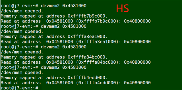

root@j7-evm:~#
7.media-ctl
root@j7-evm:~# media-ctl -p Media controller API version 5.10.162 [ 50.594634] [ 50.594634] ___________________ub960_init_cfg____________________ Media device information ------------------------ driver [ 50.605301] [ 50.605301] ____________________ub960_set_routing____________________ j721e-csi2rx model TI-CSI2RX serial bus info platform:4500000.ticsi2rx hw revision 0x1 driver version 5.10.162 Device topology - entity 1: 4500000.ticsi2rx (17 pads, 17 links, 1 route) type V4L2 subdev subtype Unknown flags 0 device node name /dev/v4l-subdev0 routes: 0/0 -> 1/0 [ACTIVE] pad0: Sink [stream:0 fmt:UYVY8_2X8/1280x800 field:none colorspace:srgb xfer:srgb ycbcr:601 quantization:lim-range] <- "cdns_csi2rx.4504000.csi-bridge":1 [ENABLED,IMMUTABLE] pad1: Source [stream:0 fmt:UYVY8_2X8/1280x800 field:none colorspace:srgb xfer:srgb ycbcr:601 quantization:lim-range] -> "4500000.ticsi2rx context 0":0 [ENABLED,IMMUTABLE] pad2: Source -> "4500000.ticsi2rx context 1":0 [ENABLED,IMMUTABLE] pad3: Source -> "4500000.ticsi2rx context 2":0 [ENABLED,IMMUTABLE] pad4: Source -> "4500000.ticsi2rx context 3":0 [ENABLED,IMMUTABLE] pad5: Source -> "4500000.ticsi2rx context 4":0 [ENABLED,IMMUTABLE] pad6: Source -> "4500000.ticsi2rx context 5":0 [ENABLED,IMMUTABLE] pad7: Source -> "4500000.ticsi2rx context 6":0 [ENABLED,IMMUTABLE] pad8: Source -> "4500000.ticsi2rx context 7":0 [ENABLED,IMMUTABLE] pad9: Source -> "4500000.ticsi2rx context 8":0 [ENABLED,IMMUTABLE] pad10: Source -> "4500000.ticsi2rx context 9":0 [ENABLED,IMMUTABLE] pad11: Source -> "4500000.ticsi2rx context 10":0 [ENABLED,IMMUTABLE] pad12: Source -> "4500000.ticsi2rx context 11":0 [ENABLED,IMMUTABLE] pad13: Source -> "4500000.ticsi2rx context 12":0 [ENABLED,IMMUTABLE] pad14: Source -> "4500000.ticsi2rx context 13":0 [ENABLED,IMMUTABLE] pad15: Source -> "4500000.ticsi2rx context 14":0 [ENABLED,IMMUTABLE] pad16: Source -> "4500000.ticsi2rx context 15":0 [ENABLED,IMMUTABLE] - entity 19: cdns_csi2rx.4504000.csi-bridge (5 pads, 2 links, 0 route) type V4L2 subdev subtype Unknown flags 0 device node name /dev/v4l-subdev1 pad0: Sink [stream:0 fmt:UYVY8_2X8/1280x800 field:none colorspace:srgb xfer:srgb ycbcr:601 quantization:lim-range] <- "ds90ub960 6-0029":4 [ENABLED,IMMUTABLE] pad1: Source [stream:0 fmt:UYVY8_2X8/1280x800 field:none colorspace:srgb xfer:srgb ycbcr:601 quantization:lim-range] -> "4500000.ticsi2rx":0 [ENABLED,IMMUTABLE] pad2: Source [stream:0 fmt:UYVY8_2X8/1280x800 field:none colorspace:srgb xfer:srgb ycbcr:601 quantization:lim-range] pad3: Source [stream:0 fmt:UYVY8_2X8/1280x800 field:none colorspace:srgb xfer:srgb ycbcr:601 quantization:lim-range] pad4: Source [stream:0 fmt:UYVY8_2X8/1280x800 field:none colorspace:srgb xfer:srgb ycbcr:601 quantization:lim-range] - entity 25: ds90ub960 6-0029 (5 pads, 5 links, 1 route) type V4L2 subdev subtype Unknown flags 0 device node name /dev/v4l-subdev2 routes: 0/0 -> 4/0 [ACTIVE] pad0: Sink [stream:0 fmt:UYVY8_2X8/1280x800 field:none colorspace:srgb xfer:srgb ycbcr:601 quantization:lim-range] <- "ds90ub953 6-0044":1 [ENABLED,IMMUTABLE] pad1: Sink <- "ds90ub953 6-0045":1 [ENABLED,IMMUTABLE] pad2: Sink <- "ds90ub953 6-0046":1 [ENABLED,IMMUTABLE] pad3: Sink <- "ds90ub953 6-0047":1 [ENABLED,IMMUTABLE] pad4: Source [stream:0 fmt:UYVY8_2X8/1280x800 field:none colorspace:srgb xfer:srgb ycbcr:601 quantization:lim-range] -> "cdns_csi2rx.4504000.csi-bridge":0 [ENABLED,IMMUTABLE] - entity 33: ds90ub953 6-0044 (2 pads, 2 links, 1 route) type V4L2 subdev subtype Unknown flags 0 device node name /dev/v4l-subdev3 routes: 0/0 -> 1/0 [ACTIVE] pad0: Sink [stream:0 fmt:UYVY8_2X8/1280x800 field:none colorspace:srgb xfer:srgb ycbcr:601 quantization:lim-range] <- "imx390 10-0021":0 [ENABLED,IMMUTABLE] pad1: Source [stream:0 fmt:UYVY8_2X8/1280x800 field:none colorspace:srgb xfer:srgb ycbcr:601 quantization:lim-range] -> "ds90ub960 6-0029":0 [ENABLED,IMMUTABLE] - entity 38: ds90ub953 6-0045 (2 pads, 2 links, 1 route) type V4L2 subdev subtype Unknown flags 0 device node name /dev/v4l-subdev4 routes: 0/0 -> 1/0 [ACTIVE] pad0: Sink [stream:0 fmt:UYVY8_2X8/1280x800 field:none colorspace:srgb xfer:srgb ycbcr:601 quantization:lim-range] <- "imx390 11-0021":0 [ENABLED,IMMUTABLE] pad1: Source [stream:0 fmt:UYVY8_2X8/1280x800 field:none colorspace:srgb xfer:srgb ycbcr:601 quantization:lim-range] -> "ds90ub960 6-0029":1 [ENABLED,IMMUTABLE] - entity 43: ds90ub953 6-0046 (2 pads, 2 links, 1 route) type V4L2 subdev subtype Unknown flags 0 device node name /dev/v4l-subdev5 routes: 0/0 -> 1/0 [ACTIVE] pad0: Sink [stream:0 fmt:UYVY8_2X8/1280x800 field:none colorspace:srgb xfer:srgb ycbcr:601 quantization:lim-range] <- "imx390 12-0021":0 [ENABLED,IMMUTABLE] pad1: Source [stream:0 fmt:UYVY8_2X8/1280x800 field:none colorspace:srgb xfer:srgb ycbcr:601 quantization:lim-range] -> "ds90ub960 6-0029":2 [ENABLED,IMMUTABLE] - entity 48: ds90ub953 6-0047 (2 pads, 2 links, 1 route) type V4L2 subdev subtype Unknown flags 0 device node name /dev/v4l-subdev6 routes: 0/0 -> 1/0 [ACTIVE] pad0: Sink [stream:0 fmt:UYVY8_2X8/1280x800 field:none colorspace:srgb xfer:srgb ycbcr:601 quantization:lim-range] <- "imx390 13-0021":0 [ENABLED,IMMUTABLE] pad1: Source [stream:0 fmt:UYVY8_2X8/1280x800 field:none colorspace:srgb xfer:srgb ycbcr:601 quantization:lim-range] -> "ds90ub960 6-0029":3 [ENABLED,IMMUTABLE] - entity 53: imx390 10-0021 (1 pad, 1 link, 2 routes) type V4L2 subdev subtype Sensor flags 0 device node name /dev/v4l-subdev7 routes: 0/0 -> 0/0 [ACTIVE, IMMUTABLE, SOURCE] 0/0 -> 0/1 [INACTIVE, IMMUTABLE, SOURCE] pad0: Source [stream:0 fmt:UYVY8_2X8/1280x800@1/30 field:none colorspace:smpte170m] -> "ds90ub953 6-0044":0 [ENABLED,IMMUTABLE] - entity 57: imx390 11-0021 (1 pad, 1 link, 2 routes) type V4L2 subdev subtype Sensor flags 0 device node name /dev/v4l-subdev8 routes: 0/0 -> 0/0 [ACTIVE, IMMUTABLE, SOURCE] 0/0 -> 0/1 [INACTIVE, IMMUTABLE, SOURCE] pad0: Source [stream:0 fmt:UYVY8_2X8/1280x800@1/30 field:none colorspace:smpte170m] -> "ds90ub953 6-0045":0 [ENABLED,IMMUTABLE] - entity 61: imx390 12-0021 (1 pad, 1 link, 2 routes) type V4L2 subdev subtype Sensor flags 0 device node name /dev/v4l-subdev9 routes: 0/0 -> 0/0 [ACTIVE, IMMUTABLE, SOURCE] 0/0 -> 0/1 [INACTIVE, IMMUTABLE, SOURCE] pad0: Source [stream:0 fmt:UYVY8_2X8/1280x800@1/30 field:none colorspace:smpte170m] -> "ds90ub953 6-0046":0 [ENABLED,IMMUTABLE] - entity 65: imx390 13-0021 (1 pad, 1 link, 2 routes) type V4L2 subdev subtype Sensor flags 0 device node name /dev/v4l-subdev10 routes: 0/0 -> 0/0 [ACTIVE, IMMUTABLE, SOURCE] 0/0 -> 0/1 [INACTIVE, IMMUTABLE, SOURCE] pad0: Source [stream:0 fmt:UYVY8_2X8/1280x800@1/30 field:none colorspace:smpte170m] -> "ds90ub953 6-0047":0 [ENABLED,IMMUTABLE] - entity 71: 4500000.ticsi2rx context 0 (1 pad, 1 link, 0 route) type Node subtype V4L flags 0 device node name /dev/video2 pad0: Sink <- "4500000.ticsi2rx":1 [ENABLED,IMMUTABLE] - entity 77: 4500000.ticsi2rx context 1 (1 pad, 1 link, 0 route) type Node subtype V4L flags 0 device node name /dev/video3 pad0: Sin[ 51.266424] bridge: filtering via arp/ip/ip6tables is no longer available by default. Update your scripts to load br_netfilter if you need this. k <- "4500000.ticsi2rx":2 [ENABLED,IMMUTABLE] - entity 83:[ 51.286326] Bridge firewalling registered 4500000.ticsi2rx context 2 (1 pad, 1 link, 0 route) type Node subtype V4L flags 0 device node name /dev/video4 pad0: Sink <- "4500000.ticsi2rx":3 [ENABLED,IMMUTABLE] - entity 89: 4500000.ticsi2rx context 3 (1 pad, 1 link, 0 route) type Node subtype V4L flags 0 device node name /dev/video5 pad0: Sink <- "4500000.ticsi2rx":4 [ENABLED,IMMUTABLE] - entity 95: 4500000.ticsi2rx context 4 (1 pad, 1 link, 0 route) type Node subtype V4L flags 0 device node name /dev/video6 pad0: Sink <- "4500000.ticsi2rx":5 [ENABLED,IMMUTABLE] - entity 101: 4500000.ticsi2rx context 5 (1 pad, 1 link, 0 route) type Node subtype V4L flags 0 device node name /dev/video7 pad0: Sink <- "4500000.ticsi2rx":6 [ENABLED,IMMUTABLE] - entity 107: 4500000.ticsi2rx context 6 (1 pad, 1 link, 0 route) type Node subtype V4L flags 0 device node name /dev/video8 pad0: Sink <- "4500000.ticsi2rx":7 [ENABLED,IMMUTABLE] - entity 113: 4500000.ticsi2rx context 7 (1 pad, 1 link, 0 route) type Node subtype V4L flags 0 device node name /dev/video9 pad0: Sink <- "4500000.ticsi2rx":8 [ENABLED,IMMUTABLE] - entity 119: 4500000.ticsi2rx context 8 (1 pad, 1 link, 0 route) type Node subtype V4L flags 0 device node name /dev/video10 pad0: Sink <- "4500000.ticsi2rx":9 [ENABLED,IMMUTABLE] - entity 125: 4500000.ticsi2rx context 9 (1 pad, 1 link, 0 route) type Node subtype V4L flags 0 device node name /dev/video11 pad0: Sink <- "4500000.ticsi2rx":10 [ENABLED,IMMUTABLE] - entity 131: 4500000.ticsi2rx context 10 (1 pad, 1 link, 0 route) type Node subtype V4L flags 0 dev[ 51.449275] Initializing XFRM netlink socket ice node name /dev/video12 pad0: Sink <- "4500000.ticsi2rx":11 [ENABLED,IMMUTABLE] - entity 137: 4500000.ticsi2rx context 11 (1 pad, 1 link, 0 route) type Node subtype V4L flags 0 device node name /dev/video13 pad0: Sink <- "4500000.ticsi2rx":12 [ENABLED,IMMUTABLE] - entity 143: 4500000.ticsi2rx context 12 (1 pad, 1 link, 0 route) type Node subtype V4L flags 0 device node name /dev/video14 pad0: Sink <- "4500000.ticsi2rx":13 [ENABLED,IMMUTABLE] - entity 149: 4500000.ticsi2rx context 13 (1 pad, 1 link, 0 route) type Node subtype V4L flags 0 device node name /dev/video15 pad0: Sink <- "4500000.ticsi2rx":14 [ENABLED,IMMUTABLE] - entity 155: 4500000.ticsi2rx context 14 (1 pad, 1 link, 0 route) type Node subtype V4L flags 0 device node name /dev/video16 pad0: Sink <- "4500000.ticsi2rx":15 [ENABLED,IMMUTABLE] - entity 161: 4500000.ticsi2rx context 15 (1 pad, 1 link, 0 route) type Node subtype V4L flags 0 device node name /dev/video17 pad0: Sink <- "4500000.ticsi2rx":16 [ENABLED,IMMUTABLE]
Cesar
Hi Nikhil,
supplement:
1. ont rtos sytem:
can capture image on rtos system,can detect HS.
and read about the csi register
#can capture image on rtos system 0x2a30000, 0x66a0ea00 0x2a30008, 0x0 0x2a3000c, 0x8 0x2a3003c, 0x0 0x2a30040, 0x0 0x2a30080, 0x0 0x2a300c0, 0x0 0x2a3013c, 0x0 0x2a30140, 0x0 0x2a30180, 0x0 0x2a301c0, 0x0 0x2a30200, 0x0 0x2a30204, 0x0 0x2a30208, 0x0 0x2a3020c, 0x0 0x4500000, 0x64706100 0x4500008, 0x0 0x450000c, 0x0 0x4500010, 0xe01 0x4500020, 0x8c00001e 0x4500024, 0x10000 0x4500028, 0x0 0x4580000, 0x0 0x4580004, 0x0 0x4580008, 0x0 0x458000c, 0x0 0x4580010, 0x0 0x4580014, 0x0 0x4580018, 0x1140 0x458001c, 0x0 0x4580020, 0x429 0x4580024, 0x5030101 0x4580028, 0x32011e 0x458002c, 0x400 0x4580030, 0x400c8 0x4580034, 0x300c8 0x4580038, 0x80103 0x458003c, 0x0 0x4580040, 0x800000 0x4580044, 0x15 0x4580048, 0x0 0x458004c, 0x0 0x4580050, 0x0 0x4580068, 0x140 0x458006c, 0x0 0x4580070, 0x694 0x4580074, 0x0 0x4580078, 0xf0501b0 0x458007c, 0x28 0x4580080, 0xa 0x4580084, 0xdecdbcab 0x4580088, 0x28 0x4580094, 0x40400 0x4580098, 0x201 0x458009c, 0x0 0x45800a0, 0x0 0x45800a4, 0x1370ba 0x45800a8, 0xee8 0x45800ac, 0x0 0x45800b0, 0x0 0x45800b4, 0x0 0x45800d8, 0x0 0x45800e4, 0x0 0x45800e8, 0x2 0x45800f0, 0xee2e803 0x45800f8, 0x23 0x4580100, 0x0 0x4580104, 0x0 0x4580108, 0x0 0x458010c, 0x0 0x4580110, 0x0 0x4580114, 0x0 0x4580118, 0x0 0x458011c, 0x0 0x4580120, 0x0 0x4580124, 0x0 0x4580128, 0x0 0x458012c, 0x0 0x4580130, 0x0 0x4580200, 0x0 0x4580204, 0x0 0x4580208, 0x0 0x458020c, 0x0 0x4580210, 0x0 0x4580214, 0x0 0x4580218, 0x0 0x458021c, 0x0 0x4580220, 0x0 0x4580224, 0x0 0x4580228, 0x0 0x458022c, 0x0 0x4580230, 0x0 0x4580234, 0x0 0x4580238, 0x0 0x458023c, 0x0 0x4580240, 0x0 0x4580244, 0x0 0x4580248, 0x0 0x458024c, 0x0 0x4580250, 0x0 0x4580254, 0x0 0x4580258, 0x0 0x458025c, 0x0 0x4580260, 0x0 0x4580264, 0x0 0x4580268, 0x0 0x458026c, 0x0 0x4580270, 0x0 0x4580274, 0xa000018 0x4580278, 0xdecdbcab 0x458027c, 0x28 0x4580280, 0x0 0x4580284, 0x0 0x4580288, 0x0 0x458028c, 0x0 0x4580290, 0x10dd0b8 0x4580294, 0x8000 0x4580298, 0x0 0x458029c, 0x5cda83 0x45802a0, 0x3c3cf3c7 0x45802a4, 0x102415 0x45802a8, 0x108000d 0x45802ac, 0x100c05 0x45802b0, 0x1020009 0x45802b4, 0x400800 0x45802b8, 0x10020 0x45802bc, 0x58a0 0x45802c0, 0x0 0x45802c4, 0x0 0x45802c8, 0x0 0x45802cc, 0x0 0x45802d0, 0x0 0x45802d4, 0x0 /dev/mem opened. Memory mapped at address 0xffff9aa60000. Read at address 0x04504000 (0xffff9aa64000): 0x8421164C /dev/mem opened. Memory mapped at address 0xffffab2b0000. Read at address 0x04504004 (0xffffab2b4004): 0x00000000 /dev/mem opened. Memory mapped at address 0xffffb4370000. Read at address 0x04504008 (0xffffb4374008): 0x43210410 /dev/mem opened. Memory mapped at address 0xffff83e30000. Read at address 0x04504010 (0xffff83e34010): 0x00000000 /dev/mem opened. Memory mapped at address 0xffffaf560000. Read at address 0x04504018 (0xffffaf564018): 0x00000000 /dev/mem opened. Memory mapped at address 0xffff87430000. Read at address 0x0450401C (0xffff8743401c): 0x00000000 /dev/mem opened. Memory mapped at address 0xffffb33e0000. Read at address 0x04504020 (0xffffb33e4020): 0x00000022 /dev/mem opened. Memory mapped at address 0xffffa5f20000. Read at address 0x04504024 (0xffffa5f24024): 0x00000000 /dev/mem opened. Memory mapped at address 0xffff8a320000. Read at address 0x04504028 (0xffff8a324028): 0x00000000 /dev/mem opened. Memory mapped at address 0xffff99000000. Read at address 0x0450402C (0xffff9900402c): 0x000F03B1 /dev/mem opened. Memory mapped at address 0xffffafc90000. Read at address 0x04504040 (0xffffafc94040): 0x0001F01F /dev/mem opened. Memory mapped at address 0xffff84150000. Read at address 0x04504048 (0xffff84154048): 0x00333306 /dev/mem opened. Memory mapped at address 0xffffa3c70000. Read at address 0x0450404C (0xffffa3c7404c): 0x00000000 /dev/mem opened. Memory mapped at address 0xffff81fa0000. Read at address 0x04504050 (0xffff81fa4050): 0x00000000 /dev/mem opened. Memory mapped at address 0xffff96b90000. Read at address 0x04504060 (0xffff96b94060): 0x10000000 /dev/mem opened. Memory mapped at address 0xffff94ea0000. Read at address 0x04504074 (0xffff94ea4074): 0x00000000 /dev/mem opened. Memory mapped at address 0xffff7eef0000. Read at address 0x04504080 (0xffff7eef4080): 0x00000000 /dev/mem opened. Memory mapped at address 0xffff97300000. Read at address 0x04504100 (0xffff97304100): 0x00000001 /dev/mem opened. Memory mapped at address 0xffff812b0000. Read at address 0x04504104 (0xffff812b4104): 0x80000133 /dev/mem opened. Memory mapped at address 0xffffb56d0000. Read at address 0x04504108 (0xffffb56d4108): 0x00000000 /dev/mem opened. Memory mapped at address 0xffffb6cc0000. Read at address 0x0450410C (0xffffb6cc410c): 0x00000100 /dev/mem opened. Memory mapped at address 0xffffa2950000. Read at address 0x04504110 (0xffffa2954110): 0x00000000 /dev/mem opened. Memory mapped at address 0xffff9f010000. Read at address 0x04504114 (0xffff9f014114): 0x00000000 /dev/mem opened. Memory mapped at address 0xffff87c60000. Read at address 0x04504118 (0xffff87c64118): 0x00000000 /dev/mem opened. Memory mapped at address 0xffff91cc0000. Read at address 0x0450411C (0xffff91cc411c): 0x00000000 /dev/mem opened. Memory mapped at address 0xffff82280000. Read at address 0x04504120 (0xffff82284120): 0x00000000 /dev/mem opened. Memory mapped at address 0xffff9f2b0000. Read at address 0x04504124 (0xffff9f2b4124): 0x00000000 /dev/mem opened. Memory mapped at address 0xffff83910000. Read at address 0x04504128 (0xffff83914128): 0x00000000 /dev/mem opened. Memory mapped at address 0xffff8cf60000. Read at address 0x04504200 (0xffff8cf64200): 0x00000000 /dev/mem opened. Memory mapped at address 0xffff95c40000. Read at address 0x04504204 (0xffff95c44204): 0x00000100 /dev/mem opened. Memory mapped at address 0xffff88a80000. Read at address 0x04504208 (0xffff88a84208): 0x00000000 /dev/mem opened. Memory mapped at address 0xffffb2f50000. Read at address 0x0450420C (0xffffb2f5420c): 0x00000000 /dev/mem opened. Memory mapped at address 0xffff90330000. Read at address 0x04504210 (0xffff90334210): 0x00000000 /dev/mem opened. Memory mapped at address 0xffff8f5f0000. Read at address 0x04504214 (0xffff8f5f4214): 0x00000000 /dev/mem opened. Memory mapped at address 0xffffb2190000. Read at address 0x04504218 (0xffffb2194218): 0x00000000 /dev/mem opened. Memory mapped at address 0xffffa5760000. Read at address 0x0450421C (0xffffa576421c): 0x00000000 /dev/mem opened. Memory mapped at address 0xffff8de40000. Read at address 0x04504220 (0xffff8de44220): 0x00000000 /dev/mem opened. Memory mapped at address 0xffff9a9f0000. Read at address 0x04504224 (0xffff9a9f4224): 0x00000000 /dev/mem opened. Memory mapped at address 0xffffb8080000. Read at address 0x04504228 (0xffffb8084228): 0x00000000 /dev/mem opened. Memory mapped at address 0xffff8fd10000. Read at address 0x04504300 (0xffff8fd14300): 0x00000000 /dev/mem opened. Memory mapped at address 0xffff8f9a0000. Read at address 0x04504304 (0xffff8f9a4304): 0x00000100 /dev/mem opened. Memory mapped at address 0xffff94b60000. Read at address 0x04504308 (0xffff94b64308): 0x00000000 /dev/mem opened. Memory mapped at address 0xffff80af0000. Read at address 0x0450430C (0xffff80af430c): 0x00000000 /dev/mem opened. Memory mapped at address 0xffffa0c80000. Read at address 0x04504310 (0xffffa0c84310): 0x00000000 /dev/mem opened. Memory mapped at address 0xffff98150000. Read at address 0x04504314 (0xffff98154314): 0x00000000 /dev/mem opened. Memory mapped at address 0xffffbac50000. Read at address 0x04504318 (0xffffbac54318): 0x00000000 /dev/mem opened. Memory mapped at address 0xffff7f590000. Read at address 0x0450431C (0xffff7f59431c): 0x00000000 /dev/mem opened. Memory mapped at address 0xffffa6190000. Read at address 0x04504320 (0xffffa6194320): 0x00000000 /dev/mem opened. Memory mapped at address 0xffff7fdc0000. Read at address 0x04504324 (0xffff7fdc4324): 0x00000000 /dev/mem opened. Memory mapped at address 0xffff9d620000. Read at address 0x04504328 (0xffff9d624328): 0x00000000 /dev/mem opened. Memory mapped at address 0xffffb6260000. Read at address 0x04504400 (0xffffb6264400): 0x00000000 /dev/mem opened. Memory mapped at address 0xffff90a40000. Read at address 0x04504404 (0xffff90a44404): 0x00000100 /dev/mem opened. Memory mapped at address 0xffff84ca0000. Read at address 0x04504408 (0xffff84ca4408): 0x00000000 /dev/mem opened. Memory mapped at address 0xffffb8f20000. Read at address 0x0450440C (0xffffb8f2440c): 0x00000000 /dev/mem opened. Memory mapped at address 0xffffaf370000. Read at address 0x04504410 (0xffffaf374410): 0x00000000 /dev/mem opened. Memory mapped at address 0xffffb3660000. Read at address 0x04504414 (0xffffb3664414): 0x00000000 /dev/mem opened. Memory mapped at address 0xffff8f070000. Read at address 0x04504418 (0xffff8f074418): 0x00000000 /dev/mem opened. Memory mapped at address 0xffff97050000. Read at address 0x0450441C (0xffff9705441c): 0x00000000 /dev/mem opened. Memory mapped at address 0xffff881c0000. Read at address 0x04504420 (0xffff881c4420): 0x00000000 /dev/mem opened. Memory mapped at address 0xffff9ba50000. Read at address 0x04504424 (0xffff9ba54424): 0x00000000 /dev/mem opened. Memory mapped at address 0xffff93920000. Read at address 0x04504428 (0xffff93924428): 0x00000000 /dev/mem opened. Memory mapped at address 0xffff94070000. Read at address 0x04504900 (0xffff94074900): 0x00000000 /dev/mem opened. Memory mapped at address 0xffff87470000. Read at address 0x04504904 (0xffff87474904): 0x00000000 /dev/mem opened. Memory mapped at address 0xffffaff70000. Read at address 0x04504908 (0xffffaff74908): 0x0000007F /dev/mem opened. Memory mapped at address 0xffff82440000. Read at address 0x0450490C (0xffff8244490c): 0x00000000 /dev/mem opened. Memory mapped at address 0xffff99a60000. Read at address 0x04504910 (0xffff99a64910): 0x0000007F /dev/mem opened. Memory mapped at address 0xffff8c090000. Read at address 0x04504920 (0xffff8c094920): 0x00000000 /dev/mem opened. Memory mapped at address 0xffff968b0000. Read at address 0x04504924 (0xffff968b4924): 0x00000000 /dev/mem opened. Memory mapped at address 0xffff7f490000. Read at address 0x04504928 (0xffff7f494928): 0x00000000 /dev/mem opened. Memory mapped at address 0xffff8c940000. Read at address 0x04504930 (0xffff8c944930): 0x00000000 /dev/mem opened. Memory mapped at address 0xffffaa640000. Read at address 0x04504934 (0xffffaa644934): 0x00000001 /dev/mem opened. Memory mapped at address 0xffff92c00000. Read at address 0x04504938 (0xffff92c04938): 0x00000000 /dev/mem opened. Memory mapped at address 0xffffbd850000. Read at address 0x04504940 (0xffffbd854940): 0x00003FFF /dev/mem opened. Memory mapped at address 0xffff93db0000. Read at address 0x04504944 (0xffff93db4944): 0x00000000 /dev/mem opened. Memory mapped at address 0xffff9b770000. Read at address 0x04504FFC (0xffff9b774ffc): 0x50220200 /dev/mem opened. Memory mapped at address 0xffffbc130000. Read at address 0x04508000 (0xffffbc138000): 0x6690A200 /dev/mem opened. Memory mapped at address 0xffff7f530000. Read at address 0x04508010 (0xffff7f538010): 0x00000000 /dev/mem opened. Memory mapped at address 0xffff89810000. Read at address 0x04508014 (0xffff89818014): 0x00000000 /dev/mem opened. Memory mapped at address 0xffff97d10000. Read at address 0x04508100 (0xffff97d18100): 0x00000000 /dev/mem opened. Memory mapped at address 0xffff84660000. Read at address 0x04508104 (0xffff84668104): 0x00000000 /dev/mem opened. Memory mapped at address 0xffffb46d0000. Read at address 0x04508300 (0xffffb46d8300): 0x00000000 /dev/mem opened. Memory mapped at address 0xffff85810000. Read at address 0x04508304 (0xffff85818304): 0x00000000 /dev/mem opened. Memory mapped at address 0xffff9e770000. Read at address 0x04508500 (0xffff9e778500): 0x00000000 /dev/mem opened. Memory mapped at address 0xffffbb000000. Read at address 0x04508504 (0xffffbb008504): 0x00000000 /dev/mem opened. Memory mapped at address 0xffffa5400000. Read at address 0x04508700 (0xffffa5408700): 0x00000000 /dev/mem opened. Memory mapped at address 0xffffa6660000. Read at address 0x04508A80 (0xffffa6668a80): 0x00000000 /dev/mem opened. Memory mapped at address 0xffff93420000. Read at address 0x04508A84 (0xffff93428a84): 0x00000000
2. on linux system
No HS detected and no image data captured
#on linux system 0x2a30000, 0x66a0ea00 0x2a30008, 0x0 0x2a3000c, 0x8 0x2a3003c, 0x0 0x2a30040, 0x0 0x2a30080, 0x0 0x2a300c0, 0x0 0x2a3013c, 0x0 0x2a30140, 0x0 0x2a30180, 0x0 0x2a301c0, 0x0 0x2a30200, 0x0 0x2a30204, 0x0 0x2a30208, 0x0 0x2a3020c, 0x0 0x4500000, 0x64706100 0x4500008, 0x0 0x450000c, 0x0 0x4500010, 0xf01 0x4500020, 0x8c00001e 0x4500024, 0x0 0x4500028, 0x0 0x4580000, 0x0 0x4580004, 0x0 0x4580008, 0x0 0x458000c, 0x0 0x4580010, 0x0 0x4580014, 0x0 0x4580018, 0x1140 0x458001c, 0x0 0x4580020, 0x429 0x4580024, 0x5030101 0x4580028, 0x32011e 0x458002c, 0x400 0x4580030, 0x400c8 0x4580034, 0x300c8 0x4580038, 0x80103 0x458003c, 0x0 0x4580040, 0x800000 0x4580044, 0x15 0x4580048, 0x0 0x458004c, 0x0 0x4580050, 0x0 0x4580068, 0x140 0x458006c, 0x0 0x4580070, 0x694 0x4580074, 0x0 0x4580078, 0xf0501b0 0x458007c, 0x28 0x4580080, 0xa 0x4580084, 0xdecdbcab 0x4580088, 0x28 0x4580094, 0x40400 0x4580098, 0x201 0x458009c, 0x0 0x45800a0, 0x0 0x45800a4, 0x1380bb 0x45800a8, 0xee8 0x45800ac, 0x0 0x45800b0, 0x0 0x45800b4, 0x0 0x45800d8, 0x0 0x45800e4, 0x0 0x45800e8, 0x2 0x45800f0, 0xee2e803 0x45800f8, 0x23 0x4580100, 0x0 0x4580104, 0x0 0x4580108, 0x0 0x458010c, 0x0 0x4580110, 0x0 0x4580114, 0x0 0x4580118, 0x0 0x458011c, 0x0 0x4580120, 0x3c00 0x4580124, 0x0 0x4580128, 0x0 0x458012c, 0x0 0x4580130, 0x0 0x4580200, 0x0 0x4580204, 0x0 0x4580208, 0x0 0x458020c, 0x0 0x4580210, 0x0 0x4580214, 0x0 0x4580218, 0x0 0x458021c, 0x0 0x4580220, 0x0 0x4580224, 0x0 0x4580228, 0x0 0x458022c, 0x0 0x4580230, 0x0 0x4580234, 0x0 0x4580238, 0x0 0x458023c, 0x0 0x4580240, 0x0 0x4580244, 0x0 0x4580248, 0x0 0x458024c, 0x0 0x4580250, 0x0 0x4580254, 0x0 0x4580258, 0x0 0x458025c, 0x0 0x4580260, 0x0 0x4580264, 0x0 0x4580268, 0x0 0x458026c, 0x0 0x4580270, 0x0 0x4580274, 0xa000018 0x4580278, 0xdecdbcab 0x458027c, 0x28 0x4580280, 0x0 0x4580284, 0x0 0x4580288, 0x0 0x458028c, 0x0 0x4580290, 0x28000 0x4580294, 0x47c00 0x4580298, 0x0 0x458029c, 0x5cda83 0x45802a0, 0x3a3af3a7 0x45802a4, 0x102411 0x45802a8, 0x1080015 0x45802ac, 0x10240d 0x45802b0, 0x1080015 0x45802b4, 0x400800 0x45802b8, 0x10020 0x45802bc, 0x58a0 0x45802c0, 0x0 0x45802c4, 0x0 0x45802c8, 0x0 0x45802cc, 0x0 0x45802d0, 0x0 0x45802d4, 0x0 /dev/mem opened. Memory mapped at address 0xffff9cf84000. Read at address 0x04504000 (0xffff9cf84000): 0x8C63164C /dev/mem opened. Memory mapped at address 0xffff9f413000. Read at address 0x04504004 (0xffff9f413004): 0x00000000 /dev/mem opened. Memory mapped at address 0xffffad0dd000. Read at address 0x04504008 (0xffffad0dd008): 0x43210400 /dev/mem opened. Memory mapped at address 0xffffb2d05000. Read at address 0x04504010 (0xffffb2d05010): 0x00000000 /dev/mem opened. Memory mapped at address 0xffffa1fe6000. Read at address 0x04504018 (0xffffa1fe6018): 0x00000000 /dev/mem opened. Memory mapped at address 0xffffb40b9000. Read at address 0x0450401C (0xffffb40b901c): 0x00000000 /dev/mem opened. Memory mapped at address 0xffffa5458000. Read at address 0x04504020 (0xffffa5458020): 0x00000000 /dev/mem opened. Memory mapped at address 0xffffb7e45000. Read at address 0x04504024 (0xffffb7e45024): 0x00000000 /dev/mem opened. Memory mapped at address 0xffff9daa8000. Read at address 0x04504028 (0xffff9daa8028): 0x00000100 /dev/mem opened. Memory mapped at address 0xffffbd2fc000. Read at address 0x0450402C (0xffffbd2fc02c): 0x00000000 /dev/mem opened. Memory mapped at address 0xffffae3ed000. Read at address 0x04504040 (0xffffae3ed040): 0x0001F01F /dev/mem opened. Memory mapped at address 0xffffae19a000. Read at address 0x04504048 (0xffffae19a048): 0x00333307 /dev/mem opened. Memory mapped at address 0xffff869e4000. Read at address 0x0450404C (0xffff869e404c): 0x00000000 /dev/mem opened. Memory mapped at address 0xffffb364b000. Read at address 0x04504050 (0xffffb364b050): 0x00000000 /dev/mem opened. Memory mapped at address 0xffffbbee1000. Read at address 0x04504060 (0xffffbbee1060): 0x10000000 /dev/mem opened. Memory mapped at address 0xffff9129e000. Read at address 0x04504074 (0xffff9129e074): 0x00000000 /dev/mem opened. Memory mapped at address 0xffff9d802000. Read at address 0x04504080 (0xffff9d802080): 0x00000000 /dev/mem opened. Memory mapped at address 0xffff86f64000. Read at address 0x04504100 (0xffff86f64100): 0x00000001 /dev/mem opened. Memory mapped at address 0xffff99e47000. Read at address 0x04504104 (0xffff99e47104): 0x80000111 /dev/mem opened. Memory mapped at address 0xffff81e0c000. Read at address 0x04504108 (0xffff81e0c108): 0x00000000 /dev/mem opened. Memory mapped at address 0xffff9b262000. Read at address 0x0450410C (0xffff9b26210c): 0x00000100 /dev/mem opened. Memory mapped at address 0xffff8d667000. Read at address 0x04504110 (0xffff8d667110): 0x00000000 /dev/mem opened. Memory mapped at address 0xffffa150d000. Read at address 0x04504114 (0xffffa150d114): 0x00000000 /dev/mem opened. Memory mapped at address 0xffff83f13000. Read at address 0x04504118 (0xffff83f13118): 0x00000000 /dev/mem opened. Memory mapped at address 0xffffbbc30000. Read at address 0x0450411C (0xffffbbc3011c): 0x00000000 /dev/mem opened. Memory mapped at address 0xffffac8e0000. Read at address 0x04504120 (0xffffac8e0120): 0x00000000 /dev/mem opened. Memory mapped at address 0xffffa3688000. Read at address 0x04504124 (0xffffa3688124): 0x00000000 /dev/mem opened. Memory mapped at address 0xffffb1ff5000. Read at address 0x04504128 (0xffffb1ff5128): 0x00000000 /dev/mem opened. Memory mapped at address 0xffff8ab81000. Read at address 0x04504200 (0xffff8ab81200): 0x00000000 /dev/mem opened. Memory mapped at address 0xffff9254b000. Read at address 0x04504204 (0xffff9254b204): 0x80000111 /dev/mem opened. Memory mapped at address 0xffffa85aa000. Read at address 0x04504208 (0xffffa85aa208): 0x00000000 /dev/mem opened. Memory mapped at address 0xffff8a311000. Read at address 0x0450420C (0xffff8a31120c): 0x00000100 /dev/mem opened. Memory mapped at address 0xffffb7f07000. Read at address 0x04504210 (0xffffb7f07210): 0x00000000 /dev/mem opened. Memory mapped at address 0xffff9fdca000. Read at address 0x04504214 (0xffff9fdca214): 0x00000000 /dev/mem opened. Memory mapped at address 0xffff84550000. Read at address 0x04504218 (0xffff84550218): 0x00000000 /dev/mem opened. Memory mapped at address 0xffffa1fd6000. Read at address 0x0450421C (0xffffa1fd621c): 0x00000000 /dev/mem opened. Memory mapped at address 0xffff9b411000. Read at address 0x04504220 (0xffff9b411220): 0x00000000 /dev/mem opened. Memory mapped at address 0xffff84900000. Read at address 0x04504224 (0xffff84900224): 0x00000000 /dev/mem opened. Memory mapped at address 0xffff8b4d1000. Read at address 0x04504228 (0xffff8b4d1228): 0x00000000 /dev/mem opened. Memory mapped at address 0xffff95e15000. Read at address 0x04504300 (0xffff95e15300): 0x00000001 /dev/mem opened. Memory mapped at address 0xffff99594000. Read at address 0x04504304 (0xffff99594304): 0x80000111 /dev/mem opened. Memory mapped at address 0xffff9bf72000. Read at address 0x04504308 (0xffff9bf72308): 0x00000000 /dev/mem opened. Memory mapped at address 0xffff80966000. Read at address 0x0450430C (0xffff8096630c): 0x00000100 /dev/mem opened. Memory mapped at address 0xffff90f32000. Read at address 0x04504310 (0xffff90f32310): 0x00000000 /dev/mem opened. Memory mapped at address 0xffffbd72f000. Read at address 0x04504314 (0xffffbd72f314): 0x00000000 /dev/mem opened. Memory mapped at address 0xffffa9238000. Read at address 0x04504318 (0xffffa9238318): 0x00000000 /dev/mem opened. Memory mapped at address 0xffffa737d000. Read at address 0x0450431C (0xffffa737d31c): 0x00000000 /dev/mem opened. Memory mapped at address 0xffffa472a000. Read at address 0x04504320 (0xffffa472a320): 0x00000000 /dev/mem opened. Memory mapped at address 0xffffb19ef000. Read at address 0x04504324 (0xffffb19ef324): 0x00000000 /dev/mem opened. Memory mapped at address 0xfffface39000. Read at address 0x04504328 (0xfffface39328): 0x00000000 /dev/mem opened. Memory mapped at address 0xffff88b12000. Read at address 0x04504400 (0xffff88b12400): 0x00000001 /dev/mem opened. Memory mapped at address 0xffff951a6000. Read at address 0x04504404 (0xffff951a6404): 0x80000111 /dev/mem opened. Memory mapped at address 0xffffb0418000. Read at address 0x04504408 (0xffffb0418408): 0x00000000 /dev/mem opened. Memory mapped at address 0xffff82227000. Read at address 0x0450440C (0xffff8222740c): 0x00000100 /dev/mem opened. Memory mapped at address 0xffffaddd7000. Read at address 0x04504410 (0xffffaddd7410): 0x00000000 /dev/mem opened. Memory mapped at address 0xffff885d0000. Read at address 0x04504414 (0xffff885d0414): 0x00000000 /dev/mem opened. Memory mapped at address 0xffff99e23000. Read at address 0x04504418 (0xffff99e23418): 0x00000000 /dev/mem opened. Memory mapped at address 0xffffbace5000. Read at address 0x0450441C (0xffffbace541c): 0x00000000 /dev/mem opened. Memory mapped at address 0xffff8df4f000. Read at address 0x04504420 (0xffff8df4f420): 0x00000000 /dev/mem opened. Memory mapped at address 0xffffa9a2d000. Read at address 0x04504424 (0xffffa9a2d424): 0x00000000 /dev/mem opened. Memory mapped at address 0xffff886f5000. Read at address 0x04504428 (0xffff886f5428): 0x00000000 /dev/mem opened. Memory mapped at address 0xffffb766e000. Read at address 0x04504900 (0xffffb766e900): 0x00000000 /dev/mem opened. Memory mapped at address 0xffffa78d9000. Read at address 0x04504904 (0xffffa78d9904): 0x00000000 /dev/mem opened. Memory mapped at address 0xffffa60be000. Read at address 0x04504908 (0xffffa60be908): 0x0000007F /dev/mem opened. Memory mapped at address 0xffffa2ff0000. Read at address 0x0450490C (0xffffa2ff090c): 0x00000000 /dev/mem opened. Memory mapped at address 0xffffaad36000. Read at address 0x04504910 (0xffffaad36910): 0x0000007F /dev/mem opened. Memory mapped at address 0xffffbda9d000. Read at address 0x04504920 (0xffffbda9d920): 0x00000000 /dev/mem opened. Memory mapped at address 0xffffa917f000. Read at address 0x04504924 (0xffffa917f924): 0x00000000 /dev/mem opened. Memory mapped at address 0xffffa9079000. Read at address 0x04504928 (0xffffa9079928): 0x00000000 /dev/mem opened. Memory mapped at address 0xffff9e588000. Read at address 0x04504930 (0xffff9e588930): 0x00000000 /dev/mem opened. Memory mapped at address 0xffffb0b03000. Read at address 0x04504934 (0xffffb0b03934): 0x00000001 /dev/mem opened. Memory mapped at address 0xffff8c76d000. Read at address 0x04504938 (0xffff8c76d938): 0x00000000 /dev/mem opened. Memory mapped at address 0xffffa5f3b000. Read at address 0x04504940 (0xffffa5f3b940): 0x00003FFF /dev/mem opened. Memory mapped at address 0xffff98406000. Read at address 0x04504944 (0xffff98406944): 0x00000000 /dev/mem opened. Memory mapped at address 0xffff9d5c9000. Read at address 0x04504FFC (0xffff9d5c9ffc): 0x50220200 /dev/mem opened. Memory mapped at address 0xffffbaffc000. Read at address 0x04508000 (0xffffbaffc000): 0x6690A200 /dev/mem opened. Memory mapped at address 0xffffa2f6b000. Read at address 0x04508010 (0xffffa2f6b010): 0x00000000 /dev/mem opened. Memory mapped at address 0xffff9bf3e000. Read at address 0x04508014 (0xffff9bf3e014): 0x00000000 /dev/mem opened. Memory mapped at address 0xffff9aea8000. Read at address 0x04508100 (0xffff9aea8100): 0x00000000 /dev/mem opened. Memory mapped at address 0xffff923c3000. Read at address 0x04508104 (0xffff923c3104): 0x00000000 /dev/mem opened. Memory mapped at address 0xffffbc00b000. Read at address 0x04508300 (0xffffbc00b300): 0x00000000 /dev/mem opened. Memory mapped at address 0xffff8e705000. Read at address 0x04508304 (0xffff8e705304): 0x00000000 /dev/mem opened. Memory mapped at address 0xffffb900a000. Read at address 0x04508500 (0xffffb900a500): 0x00000000 /dev/mem opened. Memory mapped at address 0xffffa56e7000. Read at address 0x04508504 (0xffffa56e7504): 0x00000000 /dev/mem opened. Memory mapped at address 0xffffb026e000. Read at address 0x04508700 (0xffffb026e700): 0x00000000 /dev/mem opened. Memory mapped at address 0xffffa2500000. Read at address 0x04508A80 (0xffffa2500a80): 0x00000000 /dev/mem opened. Memory mapped at address 0xffffa95eb000. Read at address 0x04508A84 (0xffffa95eba84): 0x00000000
I appreciate your prompt assistance
Cesar
Hi Cesar,
In the diagram, you are referring to the Maxim's deserializer MAX96722 whereas you are trying to probe UB953-960 FPD Link serdes?
Please note that the Maxim's deserializer is currently not supported in the SDK. Hence, this has not been tested/validated from TI's end.
Could you please clarify this?
Nikhil
Hi Nikhil,
I modified it based on Ub960, adding the configuration of max96722,but the name is still ub960
Cesar
Hi Cesar,
As mentioned above, Maxim GMSL based SERDES is not supported in the SDK currently. Hence it would be difficult to support here.
We don't know how Maxim SERDES works. I would suggest contacting MAXIM for the same and as it is already working on the RTOS, please review the SERDES configuration.
Nikhil
