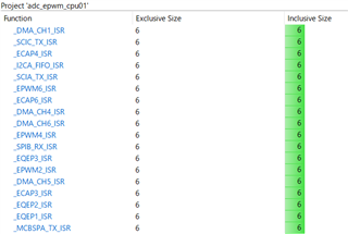

Hi
I am using CCS version 11 for test TMS320F28375D.
I can see that how many size of stack using in function at stack usage window.
Question: Is there any way to export stack usage data?
I want to get data(lools like .csv or text) of this function name, Exclusive size, and Inclusive size.

  • Hi GR,
    To get the data in text format please use TI-CGT(Code Generation Tools XML Processing Utilities) tool. To download the tool click Code Generation Tool. For guidelines regarding how to use the tool refer cg_xml_overview.pdf
    After downloading and installing the tool, do the following steps:
    •  Open command prompt and run the following command
      • <tool installation path>\utils\ofd6x -xg <path of binary file> | perl <tool installation path>\ofd\call_graph.pl > <filename to store output data>
      • e.g. C:\ofd6x -xg C:\file.out | perl call_graph.pl > D:\filename.text
    Open the file to see the stack usage in graph representation. For more information view the documentation by loading the file $install_root/index.htm into your web browser.

  • Hi Tushar,
    Thank you to your information.
    I used cgxml-2.61.00 .
    I'll write this down as a reminder.
    In this version, I could not use "perl <install path>call_graph.pl", So I replased to  "-xg | <install path>.call_graph.exe".
    GR
  • Hi GR,
    Thanks for replying. May be you don't have perl installed in your system. Instead you can use call_graph.exe.
