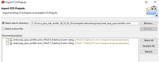

AM6442: questions of linker.cmd file
Part Number: AM6442
Hi, I'm using GPEVM-AM64 and porting to examples of Hello World, hsr_mii and enet_lwip_cpsw on A53/R5_0_0/R5_1_1 respectively.
below are linker.cmd files
By using .rprc files, I made .appimage file and download to evm board.
linker.cmd of [A53 Core]
