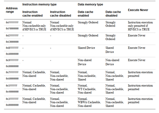

    Are you confident the experiments shown above on the R5 core were executed properly?  You should have seen different behaviors depending on the settings if the control/register had enabled the MPU along with setting up the revisions. If the behavior was the same in each test, I suspect there was something missing in the setup.  This is something which the debugger can check.  On the A core the defaults without an MMU setup would be more friendly and flat.  On the R core the arch-memory map is in effect when the MPU is off and the 0x2xxxxxxx seems to match what was reported.
    I would make a run time check using the debugger of the R5 regions (MPU is enabled, the attributes are correct, they are not overridden),  next using a bus probe to check the transaction size going to the GPMC region is a nice check.  A cptracer probe can do this.  I made a quick video to demonstrate what needs to be one on my DRA821 target.  Please do these two checks.
