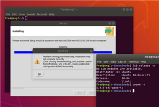

Yes, I realize this is for an older product. However, I am using the exact build specs on a native machine and this is broken.
Does any one know of a simple fix for this?
We built a dedicated Ubuntu 18 native machine just for this since it would not work well on our Ubuntu 22 stuff.
  • I understand you are trying to get AM335x SDK v6.3 setup. The documentation for that release at https://software-dl.ti.com/processor-sdk-linux/esd/docs/06_03_00_106/AM335X/linux/Overview_Building_the_SDK.html says it should support Ubuntu 18.04, so it's a great start that this is what you setup. I suspect perhaps some newer packages got integrated over the Ubuntu 18.04 lifecycle with your 18.04.06 release, breaking the installation process.
    Can you try running the installer from the command line to see if this gives you additional context/logs for the error message?
    Similarly, it seems like the installer tries to invoke an executable called cg_xml_installer. Can you also start this manually (after the failed installation) with the parameters it shows in the error message, and see what it does? From the name it sounds like a sub-installer that provides meta-files for the TI toolchain ("cg" comes from "code gen" tools usually) is what's failing.
    Also just to check the obvious, you have sufficient RAM and disk space, right?
    Regards, Andreas

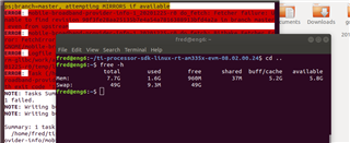

    This is another one of the U 18 machines we set up for this, it only has 8G ram the other machine in the first post is 16G, both are 50G swap. Both machines are on empty 1TB drives since they were set up just for this application. Both are our retired servers that were retired and working, one is a Dell T20 and the other is Dell T110 II.

  • This is another one of the U 18 machines we set up for this, it only has 8G ram the other machine in the first post is 16G, both are 50G swap
    That should do the trick as long as you limit the number of threads. One typically budgets about 4GB of RAM for each Yocto build thread (BB_NUMBER_THREADS).

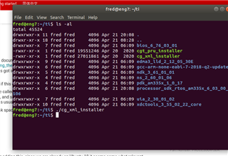

  • Can you try running the installer from the command line to see if this gives you additional context/logs for the error message?
    Hello Andreas,
    Tried to run it and it does not launch.
  • Tried to run it and it does not launch.
    You need to be applying the command line parameters as well that were shown your previous error message.
