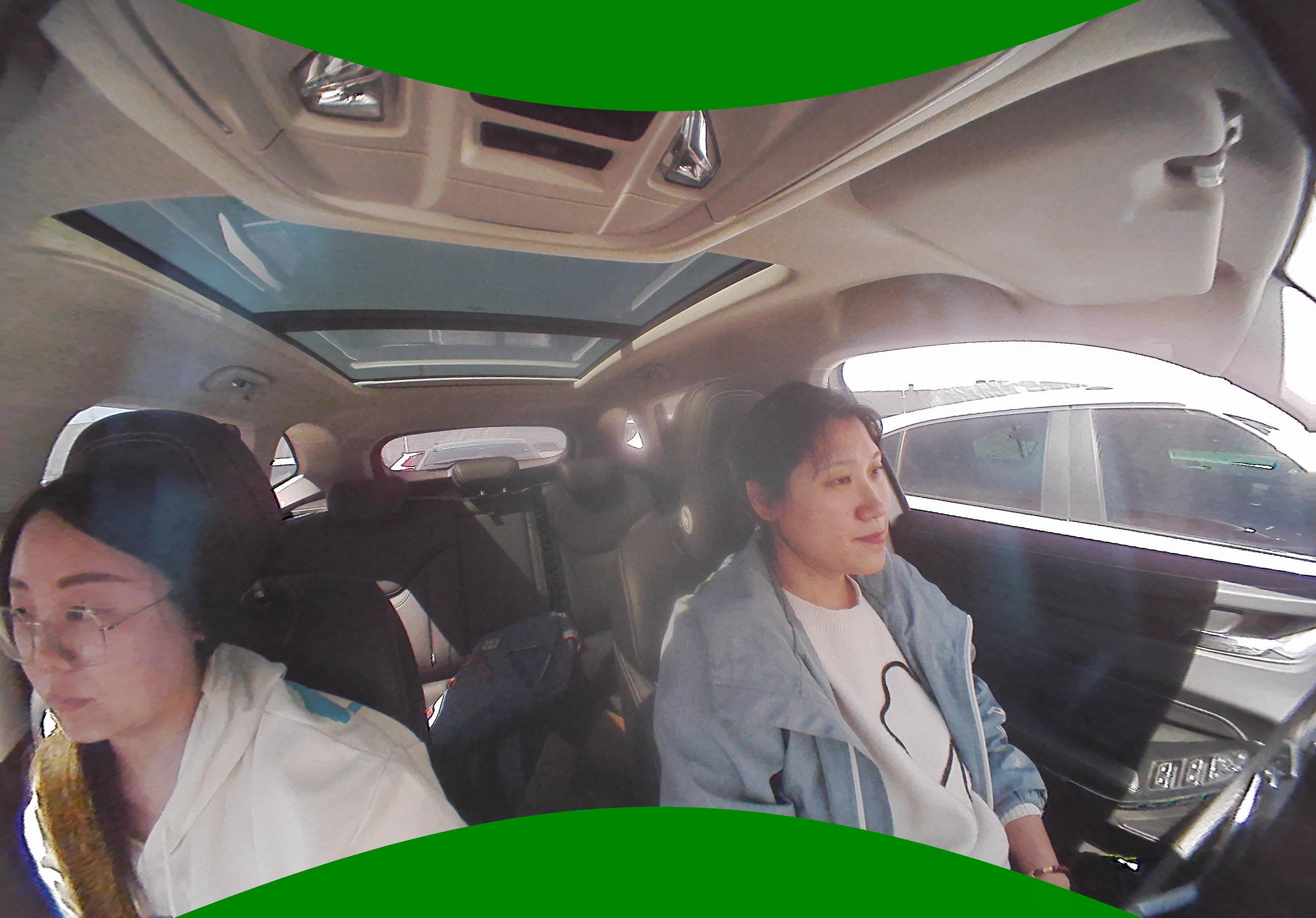

Hi Ti engineer:
The image below is the image of our output adjusting the m,s parameter in the TDA4 LDC module debugging instructions. We want to continue to remove the invalid green part of the image without changing the width of the left and right of the image, but we continue to increase the M value and decrease the S value, which cannot achieve the purpose of removing the green part of the image, so is there another way to remove the green part of the image? Can you also explain why adjusting the M and S values will change the size of the image?
There are mesh .txt and spec files with relevant settings in the attachment.
Thank you so much.

    Is the above image from matlab or tuning tool?
    Could you please share your tuning tool project for this LDC test case?
    The top and bottom part should be going out of the input image border.
    LDC shall repeat the border pixels rather than giving out green pixels.
    "m" is the mesh down sampling shall not affect the view.
    "s" is for the output view size.
    If output view size is large, it may go out of the input image border.
  • Hi Gang,
    There is the project that i am using for tuning LDC.
    OVX5B_AI505_140.zip
    Is this caused by distorition table of lens?
    In addition, if I want to keep horizontal width unchanged and in the meantime change the vertical to the edge of effective image (not include green pixel), is there a way to achieve that? Or drop the top and bottom green pixels while maintaining the LDC effec of the image attach in the case?
    Thanks.
  • Is this caused by distorition table of lens?
    There are green pixels on top and bottom of your input YUV image (probably embedded data).
    Those are repeated by LDC as border pixels.
    You may give LDC a smaller input image (cut off the top and bottom effectively).
    This is subject to your system design.
    For perspective output view, it is not possible because your input YUV is cut off on top and bottom.
    With fisheye cameras, you will have to leave the image circle completely inside your image sensor array.
